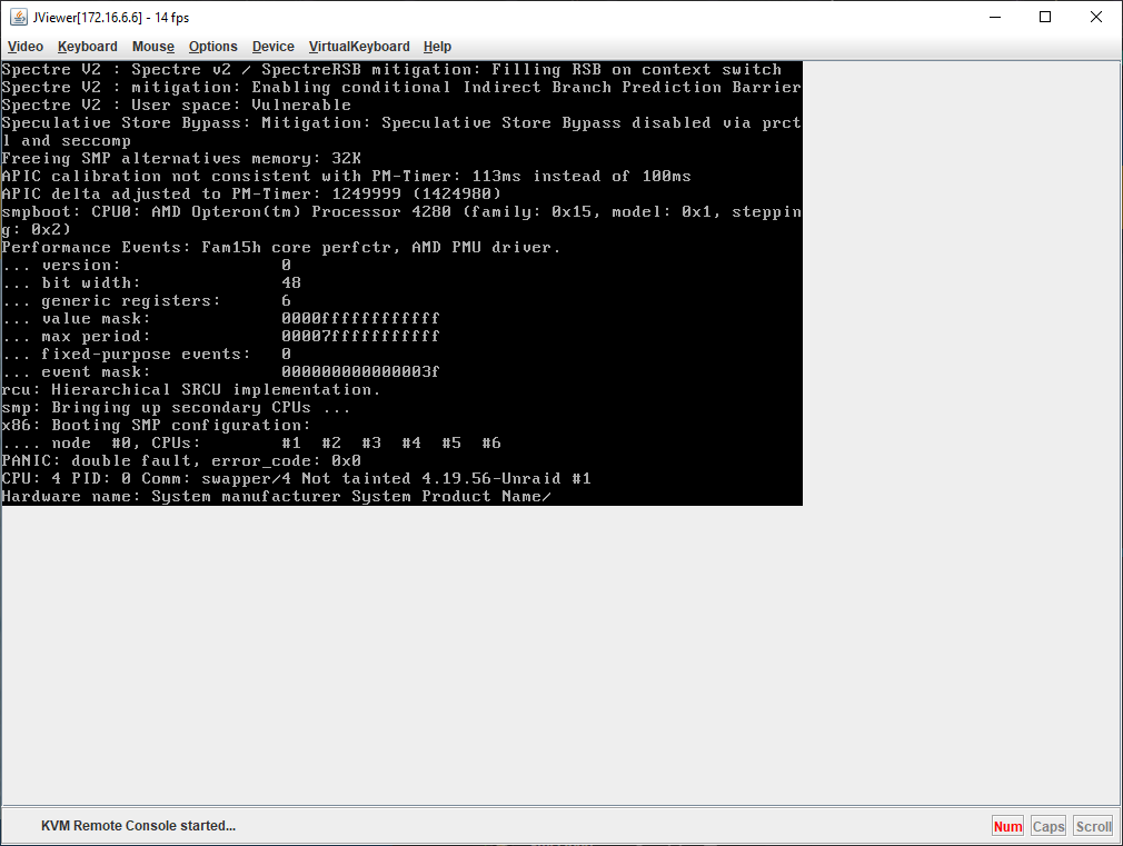

I just swapped out my old ASUS KCMA-D8 motherboard that had a bad second CPU socket for one with a working second CPU socket.  Everything is fine in the BIOS, and settings are the same.  It stops booting at smp configuration.  Anyone have any suggestions on things to check?  I'm going to start a memtest run shortly.

I am running ECC ram, but not UEFI (to old for that).  Latest boot showed an error on CPU 2 then rebooted right away.  That is why Memtest rebooted right away, I did a SMP test.  Screenshot of the panic is attached.

They are the same model & stepping.  I'm thinking the board is just fubar.  I've actually requested a refund on it and I'll go back to the board I know works but has a bad second socket.

It appears it was the CPU in socket 1 that was bad, not the CPU in socket 2.
Nevermind, its socket 1.  Board is toast.  I'll swap it back later today.
