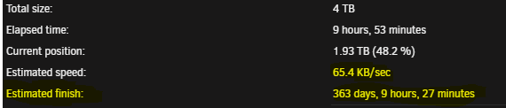

I installed a new disk (4TB to replace the 3TB that had failed) and it seemed to start OK, but when I woke up this morning to check, I see that it's going to take a year to complete at the current rate:

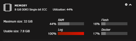

I am also seeing that the log is pegged @100% only after 7 hours of system uptime:

Should I just cancel the rebuild to power down and check the connections?
It's still stuck at 48.2% for the past 10 hours, but I don't want to do something that could result in data loss.
