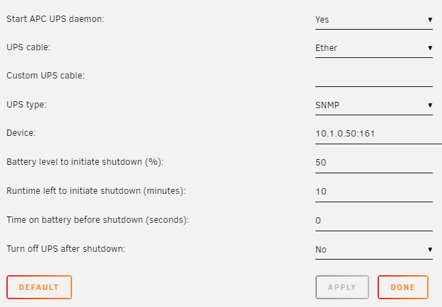

I have a Digitus DN-170091 UPS with a Mega System HDL801 NetAgent 9 network card running firmware 3.7.DL530. I've configured it in unRAID like so:
But for some reason, it is reporting that the UPS has 0.0 minutes of runtime left, so when the UPS loses power, my unRAID servers instantly shutdown.

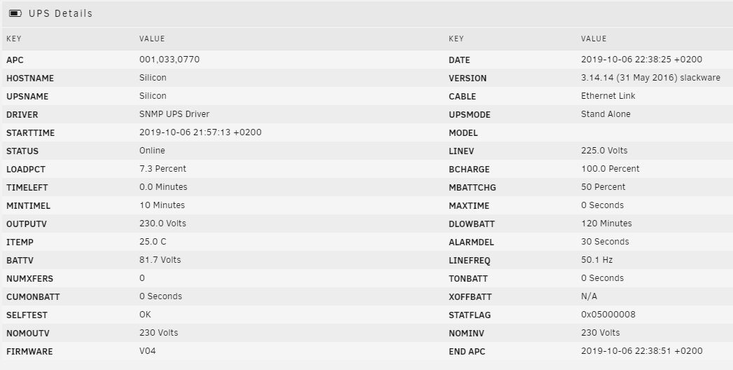

Might help if you also post a screenshot of the UPS details section
@Squid Yes, here you go:

If the power is staying on, then you may be able to get around the issue by changing battery level and runtime percent to 0, and put a rational amount of time to stay running in the time on battery field. I prefer to shut down based on how long the power is out anyway, I don't like running the batteries down on the UPS, and if the power is out for more than a minute or two, it's probably down for a couple hours, so may as well start the shutdown procedure as soon as practical.
Your UPS is reporting TIMELEFT is 0 seconds (ie: Time Left on Battery), so unRaid is handling everything correctly (because your settings says shutdown if there's less than 10 minutes remaining)

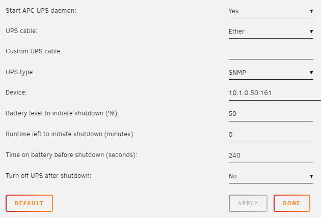

@jonathanm Update: I've set my settings to the ones you can see below, but it still initiated shutdown immediately after the UPS lost power:
@jonathanm Yes, I realized that I hadn't changed that one and tried that too after my last post, but it produced the same result...
