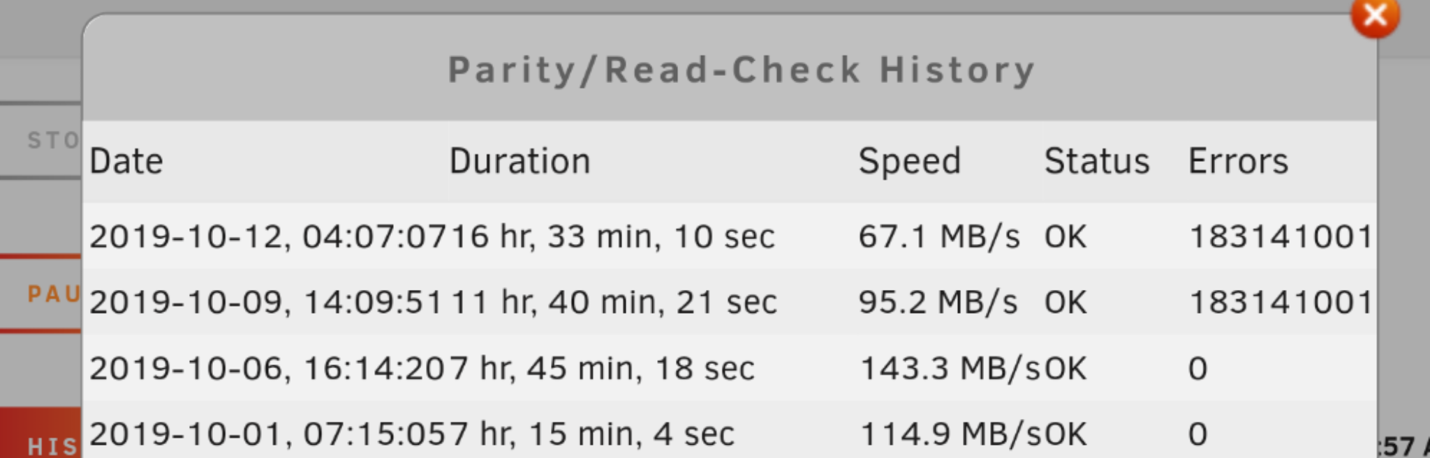

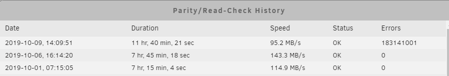

This morning I get a notification that a parity check has started, it wasn't scheduled and I don't know what triggered it. I let it run its course and it finished with 183141001 errors. This is the first time in the two years the server has been running that I have had a parity check with any errors and I am at a loss for what happened - or what I should do next. As of right now everything on the server seems to be working normally.

With so many sync errors most likely something happened during the disk replacement, but difficult to guess what without the logs covering that, still run memtest for 24H and if no errors then run another parity check to see if you get the same number of errors.
A little over 24h of memtest came back with zero errors. I re-ran the parity check and came back with the same results.
Aside from the sync errors everything looks and functions normally.
tower-diagnostics-20191012-1120.zip
Likely the problem was during the replacement, but without the diags best option now is probably to run a correcting check, but there could be corruption on the rebuilt disk, if you have checksum of your files run a check.
