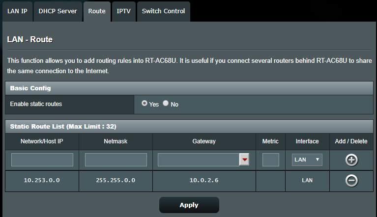

  8. So for this to work you would need a router that supports vLANs as well? It doesn't look like the stock ASUS firmware has that functionality.

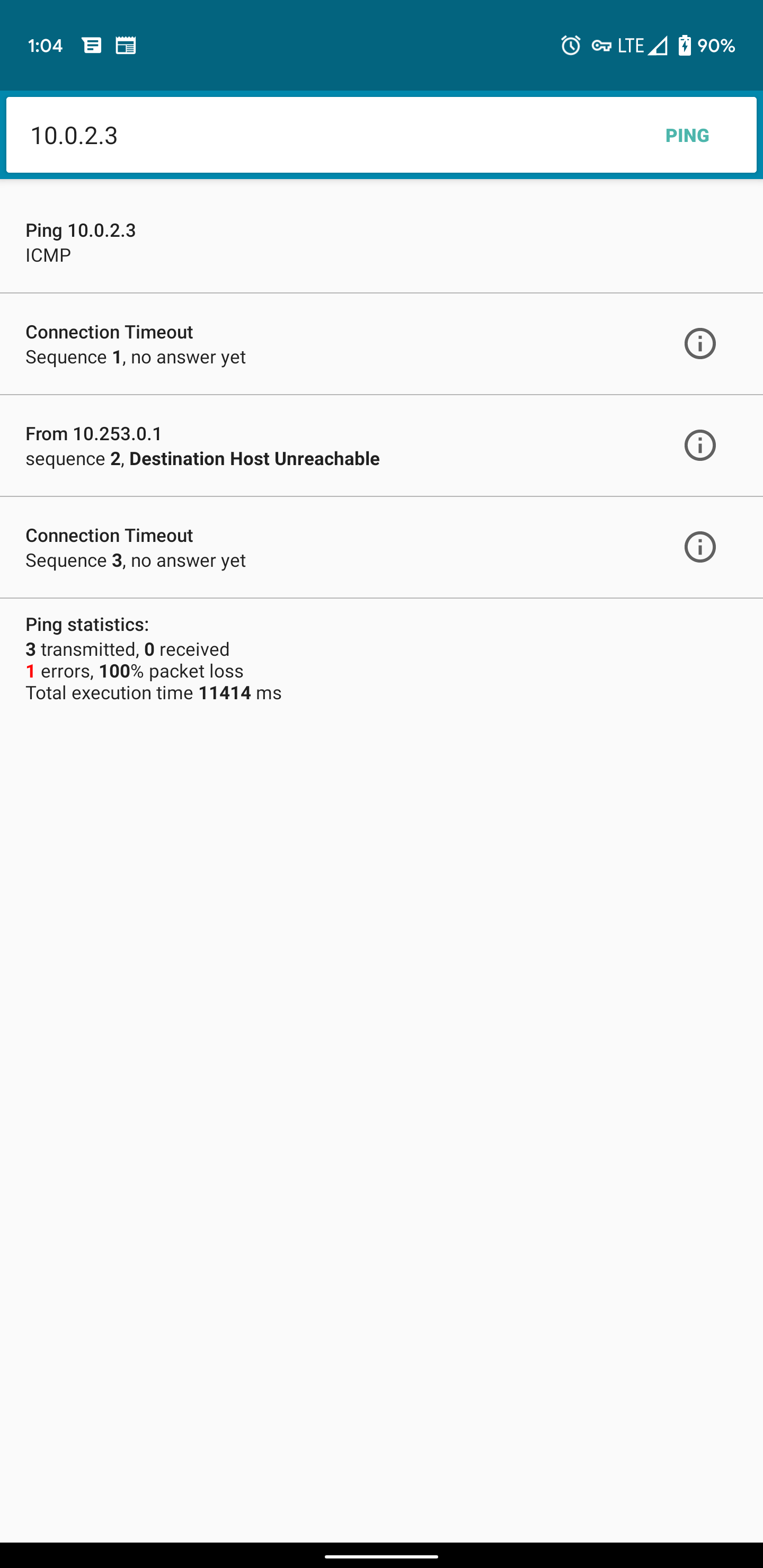

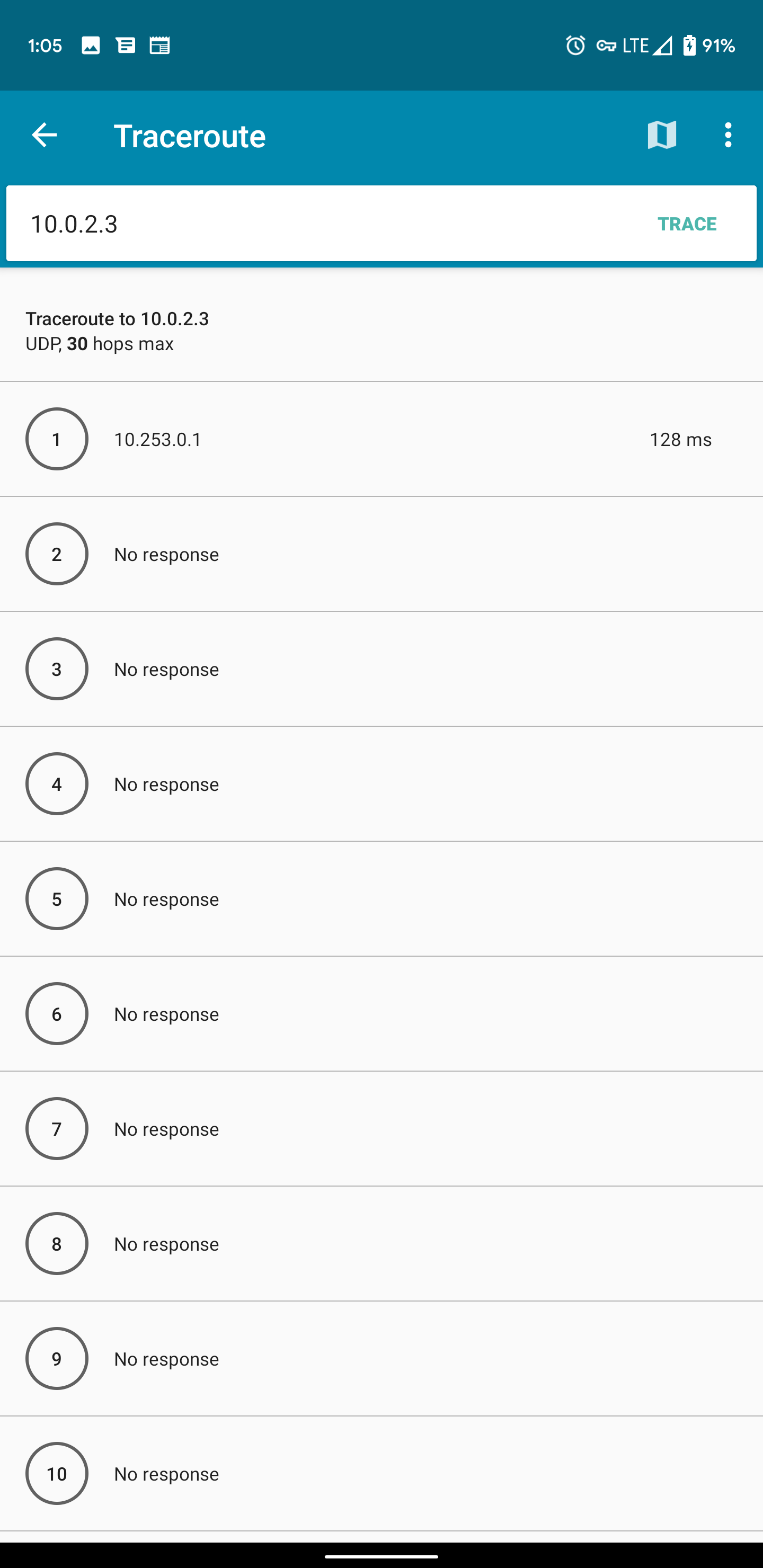

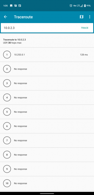

  11. Unraid is 10.0.2.6 The pi-hole container is on br0 with a custom ip of 10.0.2.3. If I connect through wireguard I can't see 10.0.2.3 to use it as a DNS.
  12. I cannot figure out how to get my phone to see the pi-hole docker container on 10.0.2.3. I have the DNS configured on the client side. Setting NAT doesn't seem to change anything either. I can see other physical nodes on the network, just not the docker assigned a custom IP.

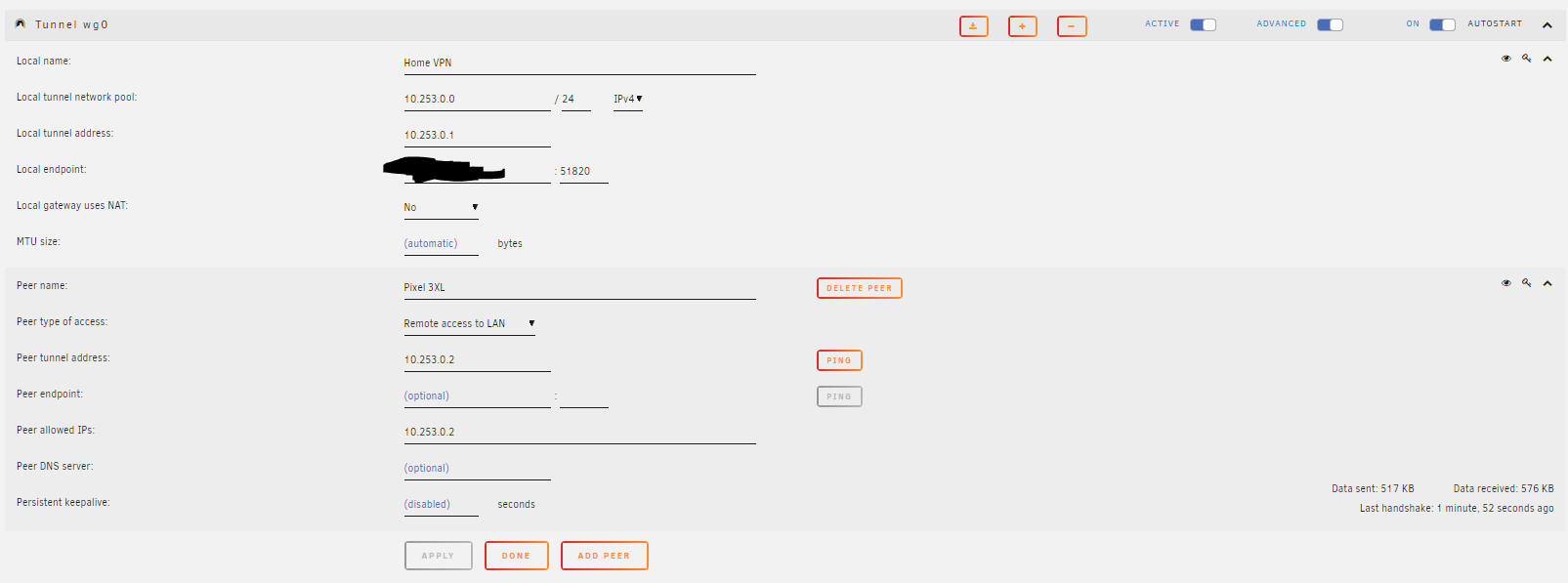

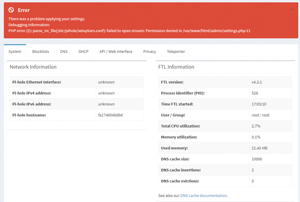

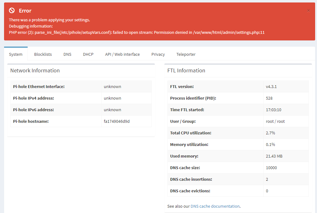

  13. I just installed the docker and the only settings I changed were setting network type to custom and the time zone to America/New_York. When I go into the admin UI I can't change anything because of this. Does anyone have any insight? Edit: It looks like running chmod 0777 -R /mnt/user/appdata/pihole/pihole/ from the terminal fixed it. After hitting save I changed it back to 0755 and everything seems to be working normally. What would cause the permission issue in the first place?
  14. Pinging 10.0.2.3 I get this:
  15. Does it go on the server side of the peer config or the client side? I tried both and nothing changed. I can access other IPs on the network, just not custom IPs from Unraid.
