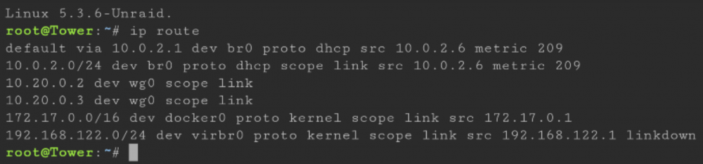

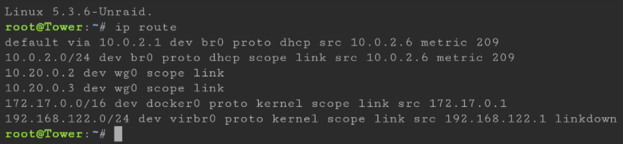

Dynamix WireGuard VPN
So for this to work you would need a router that supports vLANs as well? It doesn't look like the stock ASUS firmware has that functionality.
That works. I can use my router as the client DNS just fine, that doesn't solve the problem of not being able to access Dockers with custom IPs.
You most certainly need to be able to access it to use it. What are you talking about? You haven't added anything to this thread except say that it works for you and you don't know why.
Unraid is 10.0.2.6 The pi-hole container is on br0 with a custom ip of 10.0.2.3. If I connect through wireguard I can't see 10.0.2.3 to use it as a DNS.
I cannot figure out how to get my phone to see the pi-hole docker container on 10.0.2.3. I have the DNS configured on the client side. Setting NAT doesn't seem to change anything either. I can see other physical nodes on the network, just not the docker assigned a custom IP.
Pinging 10.0.2.3 I get this:
Does it go on the server side of the peer config or the client side? I tried both and nothing changed. I can access other IPs on the network, just not custom IPs from Unraid.
10.0.2.1 is my router 10.0.2.6 is my Unraid server 10.20.0.2 and 10.20.0.3 are peers I can connect to 10.0.2.6 and 10.0.2.1 from both peers, but I can't figure out the routing to be able to get to a docker with its own IP (10.0.2.3). I'm not currently running any VMs.

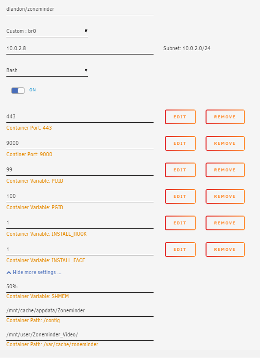

[support] dlandon - Zoneminder 1.36
I have been trying for the past few days to get this docker working. It installs fine, but no matter what I try I get ERR_CONNECTION_REFUSED on the WebUI. Ideally I would like to run it as br0 with its own IP so there won't be any port conflicts. I am running Unraid 6.7.1-rc2. The last portion of the log shows that MariaDB fails to start, but I don't know why or how I would go about fixing that. Thank you for any insight! zm_log.zip tower-diagnostics-20190615-2201.zip I have tried setting up the docker several times with no luck. It always fails starting the MariaDB server
