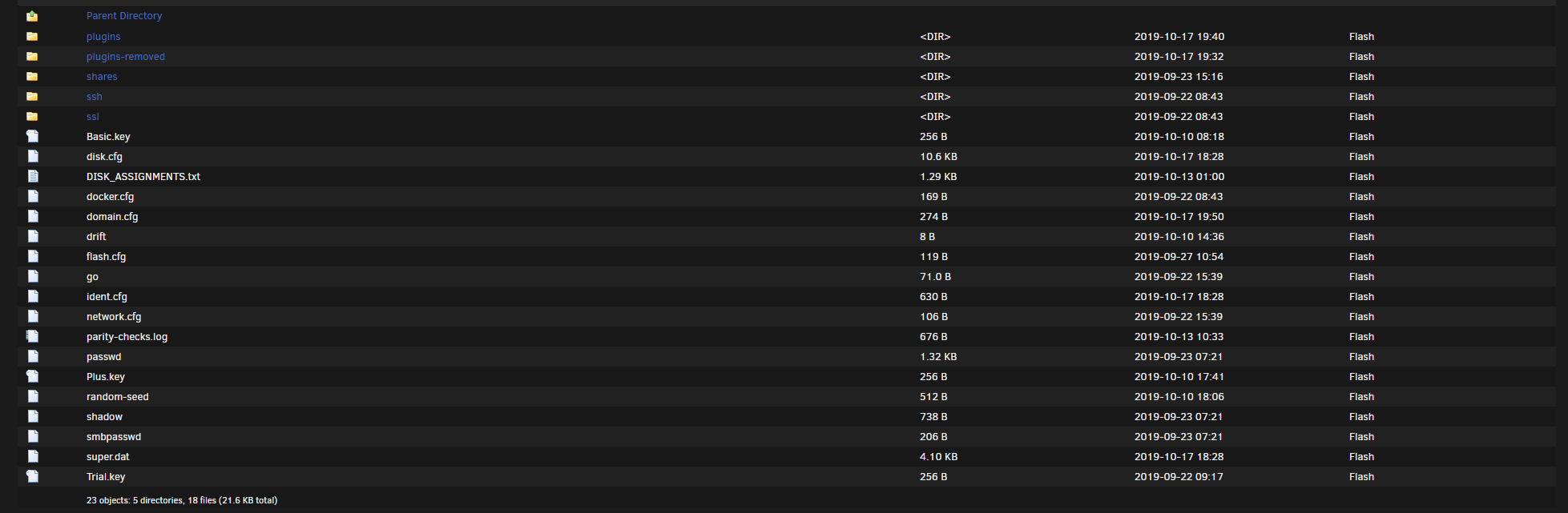

this is what i am seeing.
So i need to know if i only have one licence how do i delete the other key that is giving me the errors.
Is there a way that i can see if i have one licence that is activated or two licences.
You can only have one licence valid.    When you upgraded the previous license would have been blacklisted.    You can just delete the unused .key file off the flash drive.
So i have unhidden the flash drive and i see the basic key there but i cannot delete it .
Must the Raid be stopped for this .
So if the raid is stopped will i be able to delete the file.
