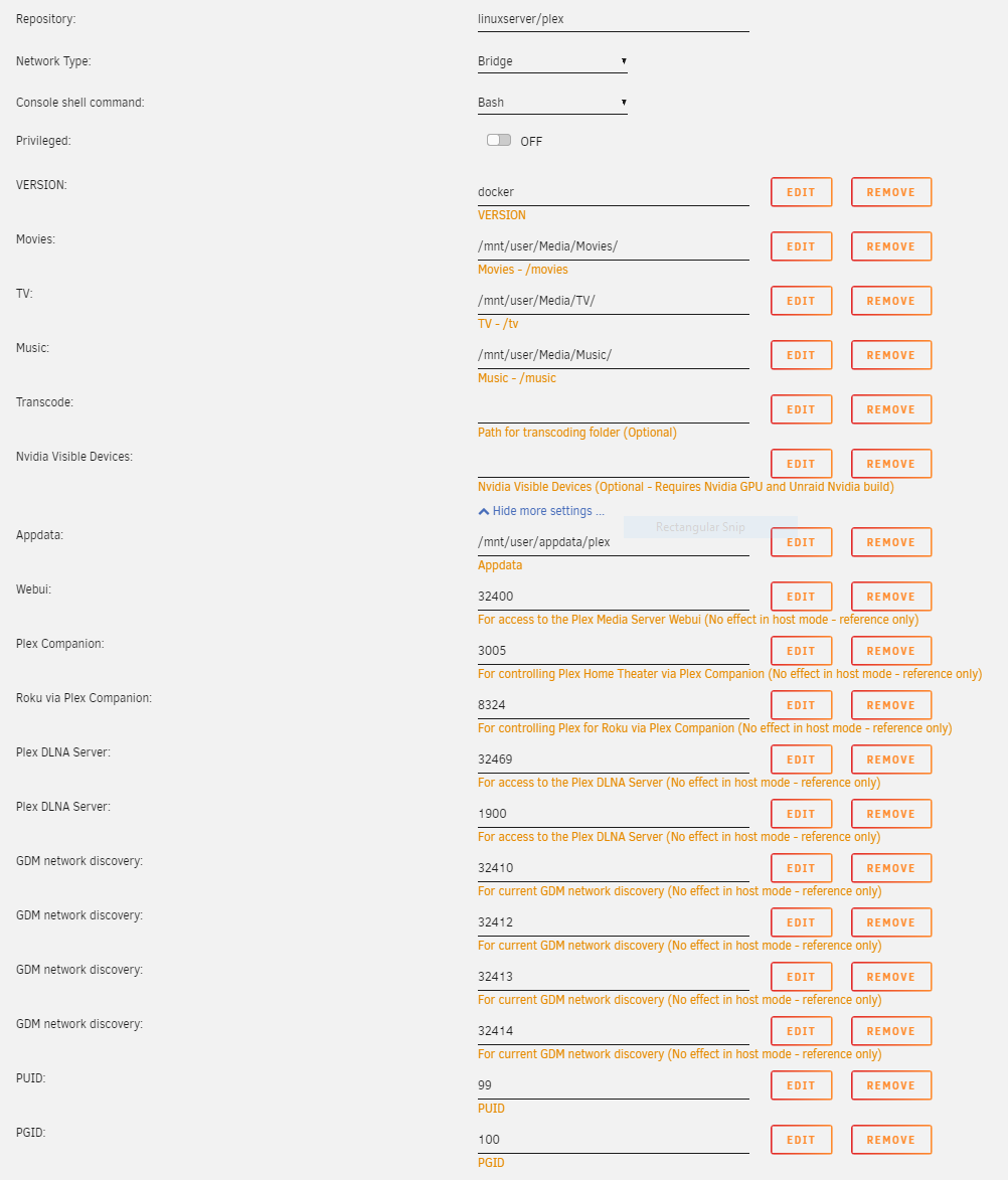

October 18, 20197 yr Believe it or not I did spend 4 hours googling this and there are no updated guides on setting this up. The guides I find are missing most of these fields. 1- Network type: Should I be using Bridge, Host, br0 or Custom? And why? (please explain what this means. I'm using br0 for Pi-Hole but I don't know why) 2- What do I map for "Transcode"? I assume I'll need to transcode. What do I do here? 3- Can I close off some of these ports? 4- How did I get upgraded to an "Advanced Member" when I'm probably the biggest idiot on here? 🤪 Edited October 18, 20197 yr by adminmat
October 18, 20197 yr Author Would LOVE to find a video guide on how to set up Plex in unraid. Funny SpaceinvaderOne didnt make one. got this:

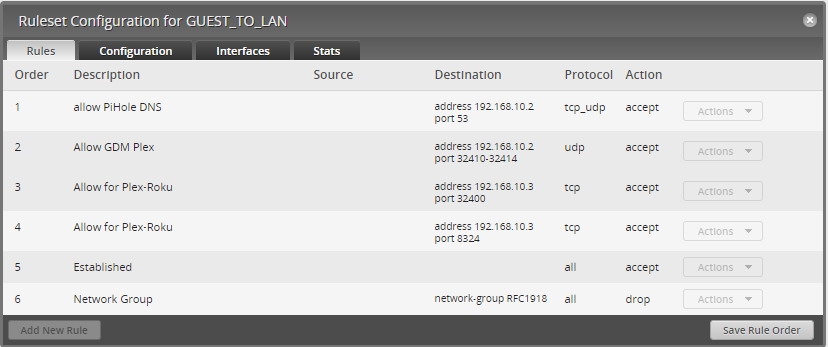

October 18, 20197 yr Author Thanks for the links but I'm not understanding when you would use a Host network type over a Bridge. I have a ESXi host running with VMs. They each have their own IP address. Which the Plex docker doesn't get if it's set up as a Host network type. I have several VLANs on my network with firewall rules separating them for security. Do i need to set up the Plex docker in Bridge mode in order for my Plex to be passed to my IoT network Roku? I tried opening port 8324 and 32400 in my router so the Plex server and the Roku can communicate locally but it's not working. Any ideas?
October 18, 20197 yr Author So update: I tried every combination of allowing ports within my network. And I can't get Plex to connect directly to the Roku. I am now trying Network Type br0 which gives Plex it's own IP address. Now I completely lost Remote Access (the slow 2mb/s connection). I still CAN connect and play directly when on the same network from within the LAN.
October 18, 20197 yr 7 hours ago, adminmat said: Thanks for the links but I'm not understanding when you would use a Host network type over a Bridge. I have a ESXi host running with VMs. They each have their own IP address. Which the Plex docker doesn't get if it's set up as a Host network type. From the Docker Docs networking section: Network drivers Docker’s networking subsystem is pluggable, using drivers. Several drivers exist by default, and provide core networking functionality: bridge: The default network driver. If you don’t specify a driver, this is the type of network you are creating. Bridge networks are usually used when your applications run in standalone containers that need to communicate. See bridge networks. host: For standalone containers, remove network isolation between the container and the Docker host, and use the host’s networking directly. host is only available for swarm services on Docker 17.06 and higher. See use the host network. overlay: Overlay networks connect multiple Docker daemons together and enable swarm services to communicate with each other. You can also use overlay networks to facilitate communication between a swarm service and a standalone container, or between two standalone containers on different Docker daemons. This strategy removes the need to do OS-level routing between these containers. See overlay networks. macvlan: Macvlan networks allow you to assign a MAC address to a container, making it appear as a physical device on your network. The Docker daemon routes traffic to containers by their MAC addresses. Using the macvlan driver is sometimes the best choice when dealing with legacy applications that expect to be directly connected to the physical network, rather than routed through the Docker host’s network stack. See Macvlan networks. none: For this container, disable all networking. Usually used in conjunction with a custom network driver. none is not available for swarm services. See disable container networking. Network plugins: You can install and use third-party network plugins with Docker. These plugins are available from Docker Hub or from third-party vendors. See the vendor’s documentation for installing and using a given network plugin. Network driver summary User-defined bridge networks are best when you need multiple containers to communicate on the same Docker host. Host networks are best when the network stack should not be isolated from the Docker host, but you want other aspects of the container to be isolated. Overlay networks are best when you need containers running on different Docker hosts to communicate, or when multiple applications work together using swarm services. Macvlan networks are best when you are migrating from a VM setup or need your containers to look like physical hosts on your network, each with a unique MAC address. Third-party network plugins allow you to integrate Docker with specialized network stacks. Personally, I have my Plex docker container set to host networking as that was the container default and I have no need to change it; however, I have several others on a docker VLAN (br0.3) so they get their own IP address. I could not use custom IP addresses on custom:br0 without getting macvlan call traces on my server, but the VLAN is fine. Most of my docker containers run in bridge mode. I usually just stick with whatever the container default is except for those I have moved to br0.3. I'll probably end up moving more here over time as I keep experimenting.

October 18, 20197 yr Author Update! I got it working! This time with much less whining on the forums as usual 😃 It was GDM Network Discovery!! I had to open a destination port range to my Plex server's IP address. Ports 32410 to 32414. So I'm allowing GDM port range 32410-32414, UDP to my Plex IP address! I'm allowing 32400 and 8324 also to the Plex IP. Thanks @Hoopster for looking at it with me.

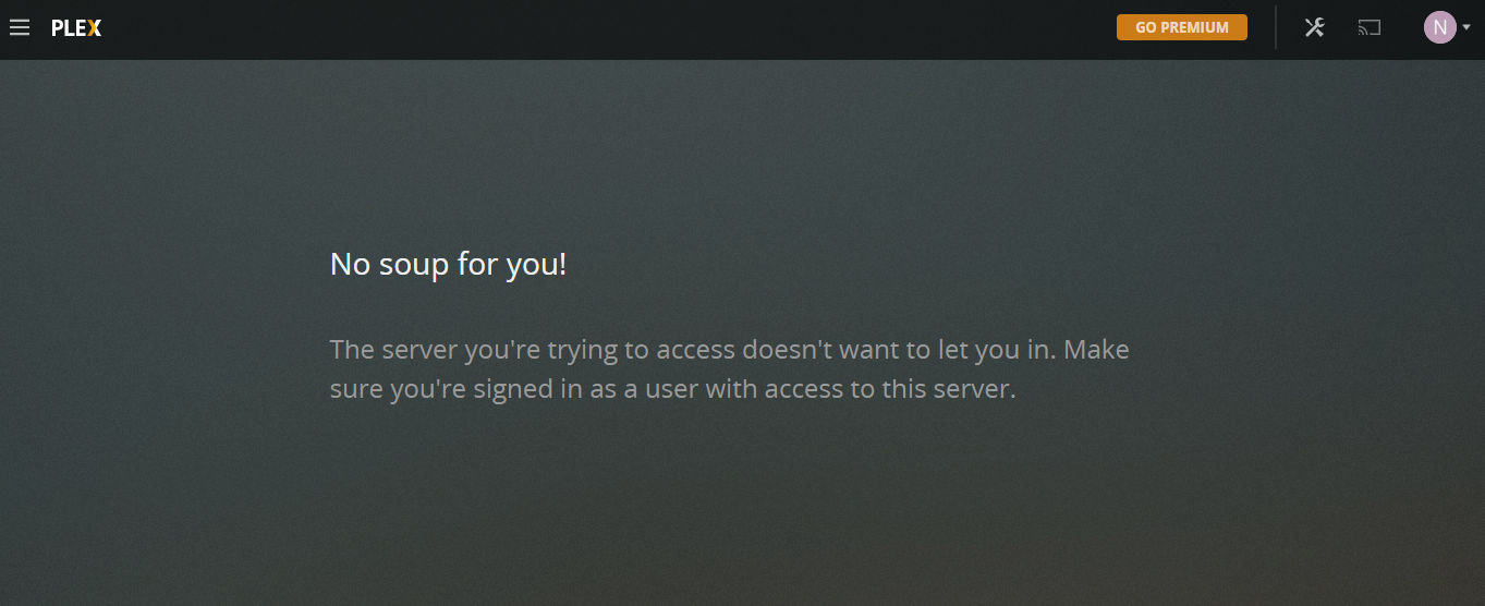

December 6, 20232 yr On 10/18/2019 at 2:24 PM, adminmat said: Update! I got it working! This time with much less whining on the forums as usual 😃 It was GDM Network Discovery!! I had to open a destination port range to my Plex server's IP address. Ports 32410 to 32414. So I'm allowing GDM port range 32410-32414, UDP to my Plex IP address! I'm allowing 32400 and 8324 also to the Plex IP. Thanks @Hoopster for looking at it with me. I am using Unifi but I'm curious if I'm having the same issue. When I setup Plex on a vlan I can launch it from the docker and it works fine. I can't access it from any other device on my network. I'm guessing I've overlooked something. When I switch it back to the same IP as unraid, everything works, including remote.
