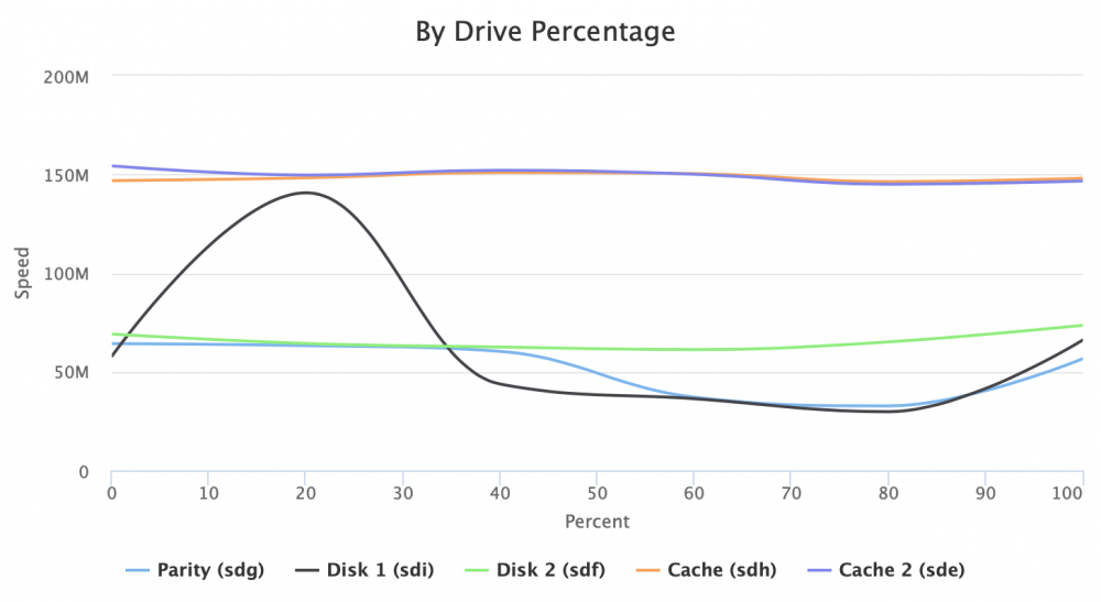

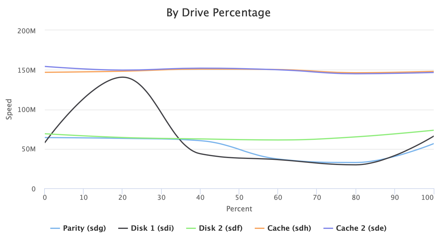

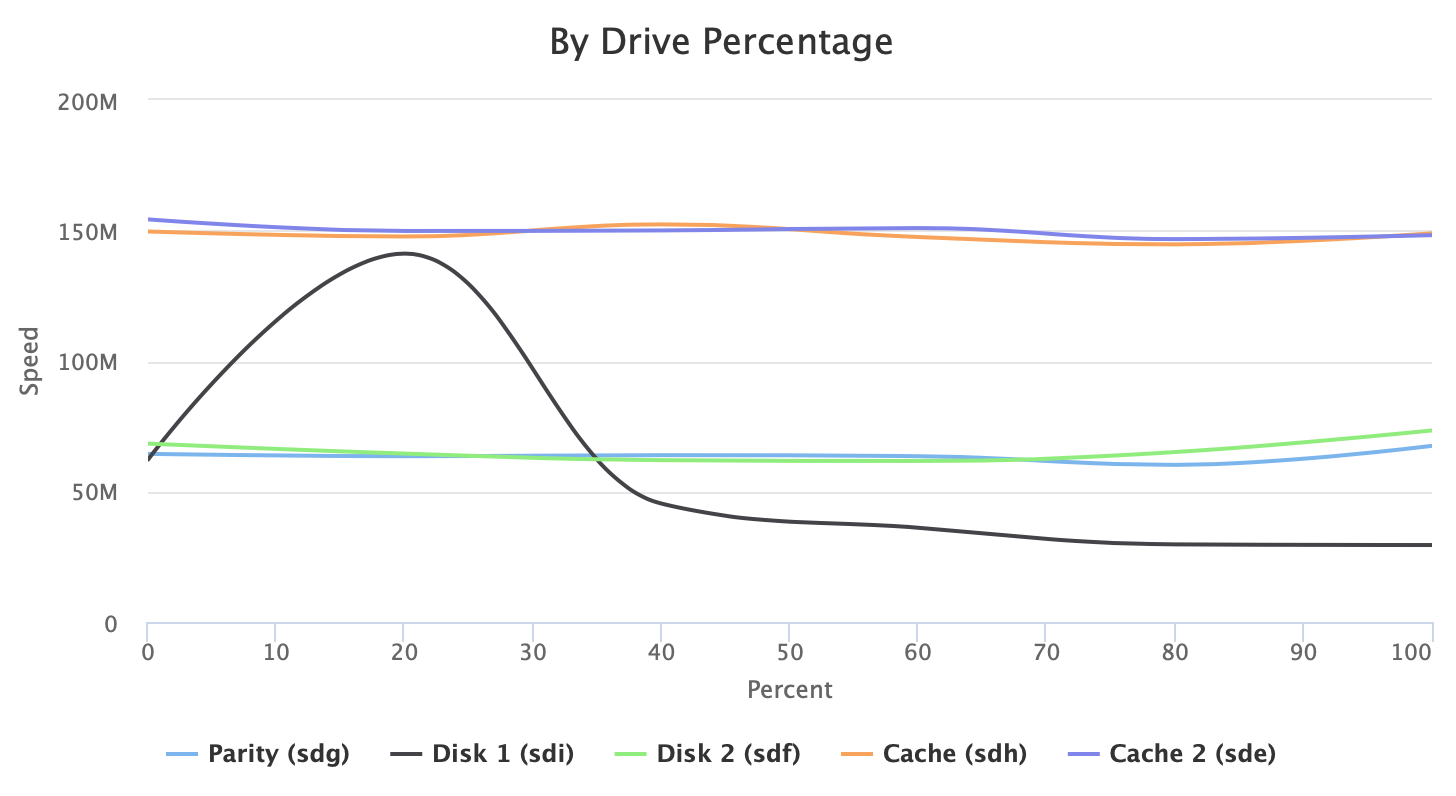

I've run the DiskSpeed docker and got the results below (x2 repeats). I stopped all my others dockers, there were no VMs running, and nothing on the network should have been accessing the server and competing for throughput.
1295593778_Screenshot2019-11-01at14_30_22.thumb.png.6e75e63e3101d84c0b97950ffff834c0.png 70455383_Screenshot2019-11-01at14_45_23.thumb.png.1187ea998dc90f0955c302feba5f009f.png

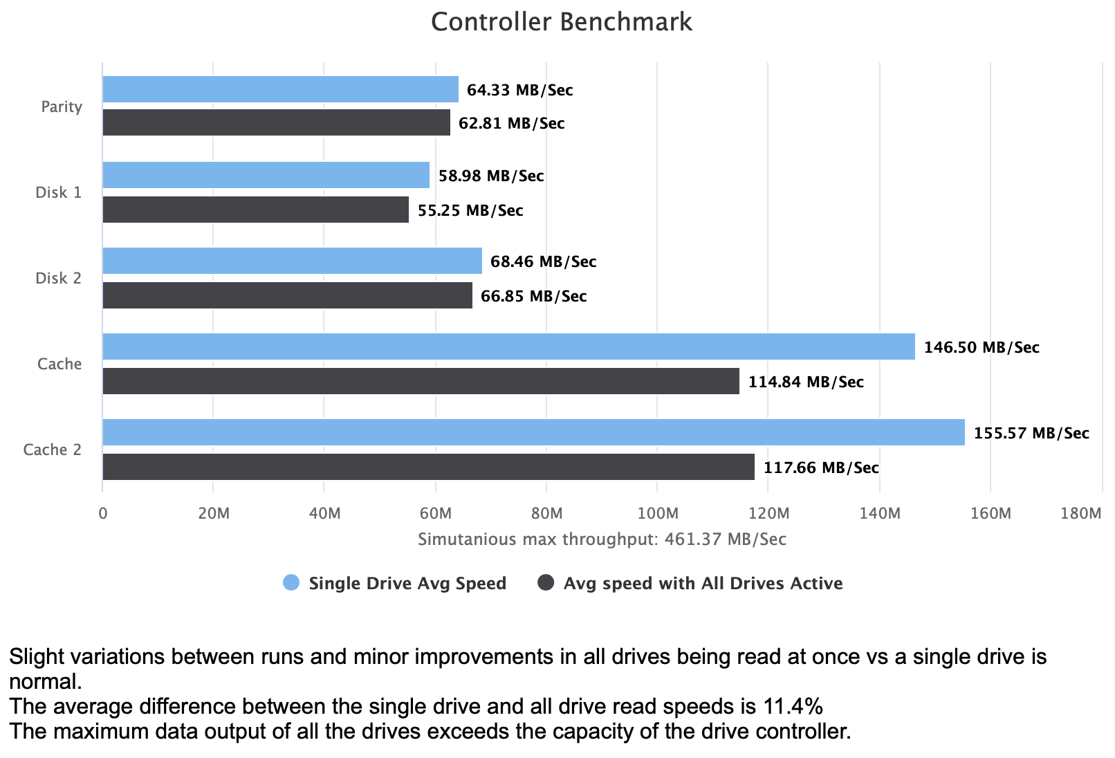

And here's the controller benchmark:
632073054_Screenshot2019-11-01at14_52_22.thumb.png.316de7824e1eae70cc0fcd13ff2cc736.png
Disk 1 is the 1 TB Red. That seems low to me...
Disks are all performing way slower than they should, since it's on multiple disks you ideally want to run the same test with a different board/controller to rule that out, or connect a new disk in the current board and test it.

I ran DiskSpeed after each change, and nothing has changed from my post above. I'm still only getting about 65 MB/s from my spinning disks and 150 MB/s from my SSDs.
