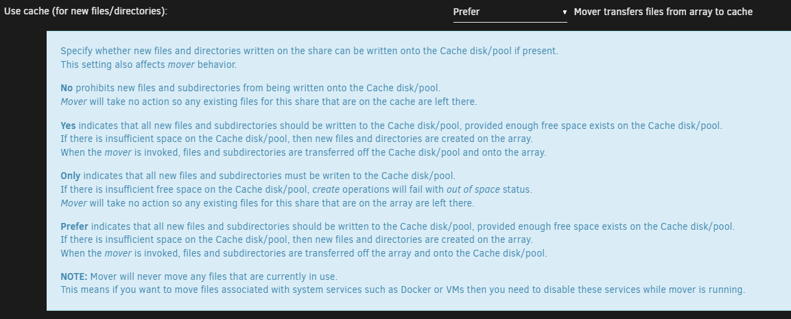

Probably the easiest thing to do is to set the 'Use cache' setting for the appdata share to 'Prefer'
Now that you have a cache drive, new appdata files will get created on the cache drive and existing appdata files on the array will be moved to the cache drive when the Mover is invoked.  You can run Mover manually or on a schedule.
Note the warning about disabling Docker and VM Manager before running Mover so no files are in use by these services when Mover runs. Anything in use will not get moved off the array and onto the cache drive.
