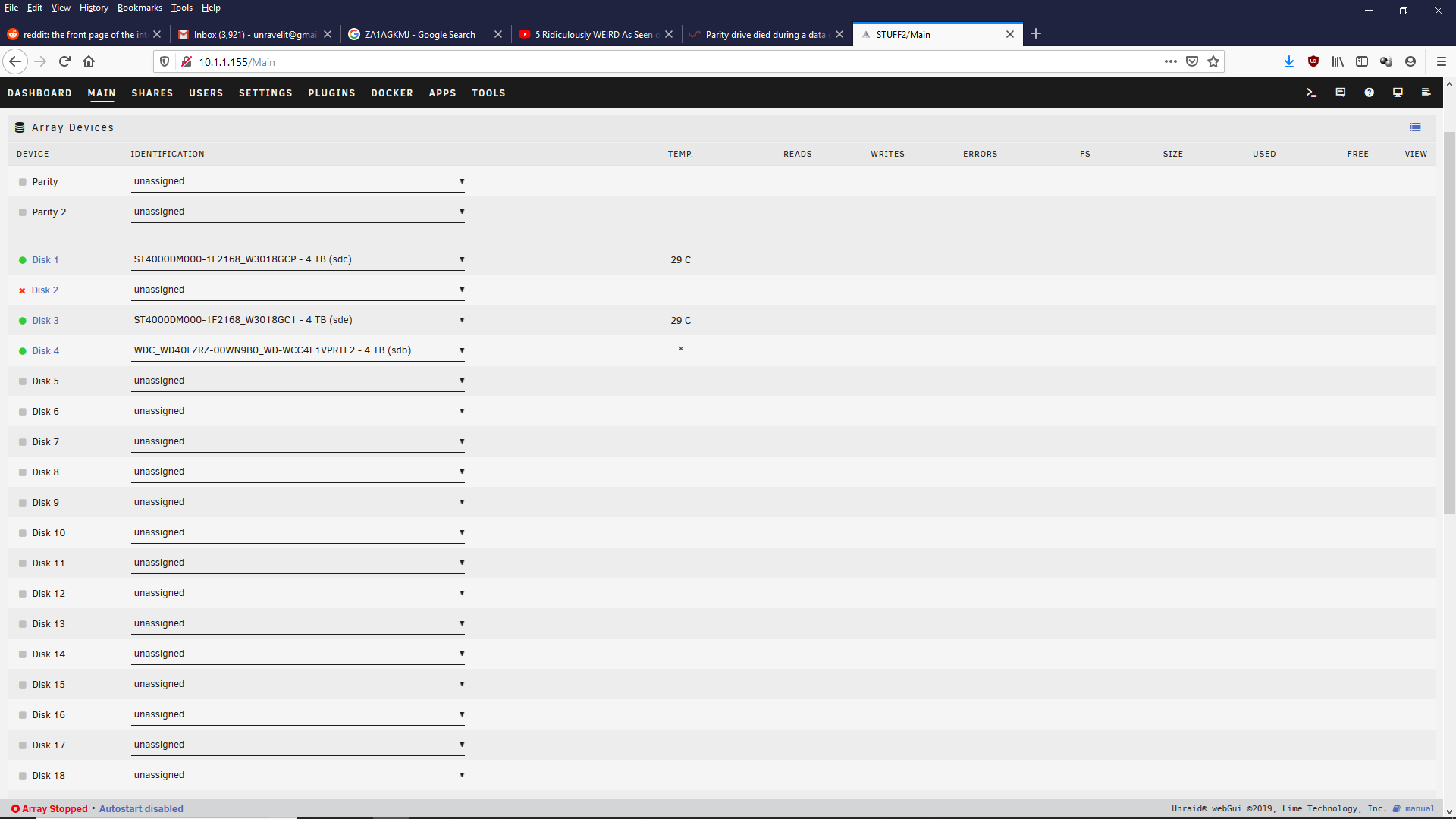

Post a screenshot of Main - Array Devices just to make sure I fully understand what you have now.

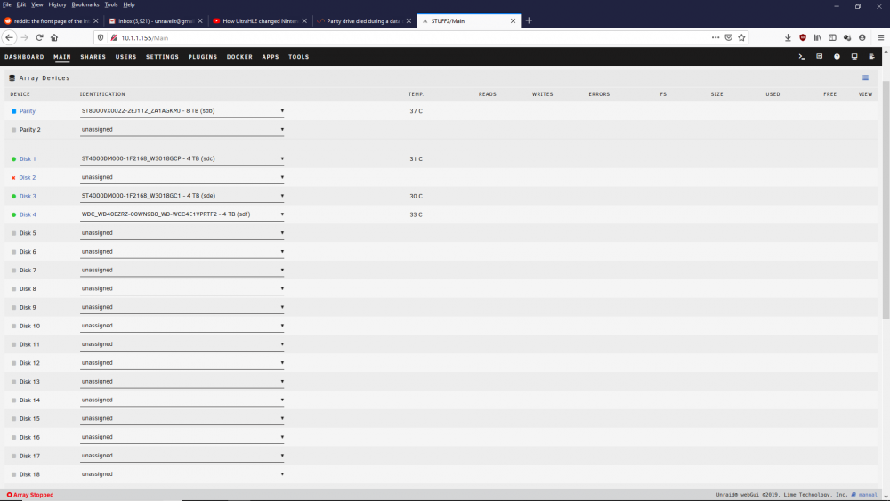

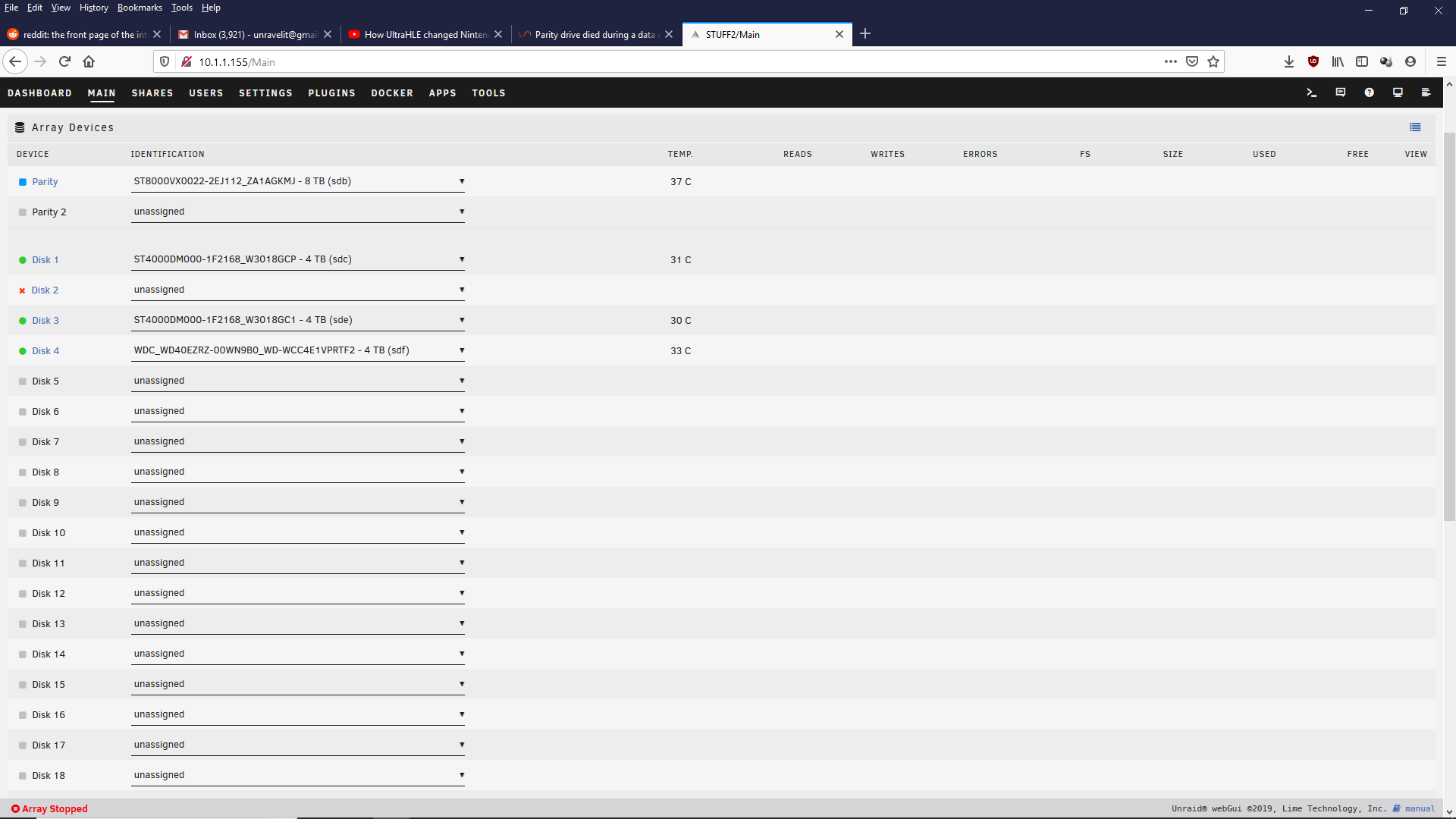

Can you assign that original parity to parity slot, and assign nothing to slot2? If it offers to rebuild parity, don't start the array. If it doesn't want to rebuild parity, start the array and see if you can see the "emulated" disk2 files. The emulated disk is exactly what will be rebuilt when you assign the new disk to slot2.
Might be best to post another screenshot before starting the array. In any case, shouldn't be anything to worry about since you still have the original disk2. Just don't format anything.
I tried that, and the parity drive shows up as a blue dot drive "NEW DEVICE"
I don't get an option to start the array at all with just the parity drive added as it says
"Too many wrong and/or missing disks!"
So it sees the parity drive, but doesn't seem to know it is meant to be the parity drive...

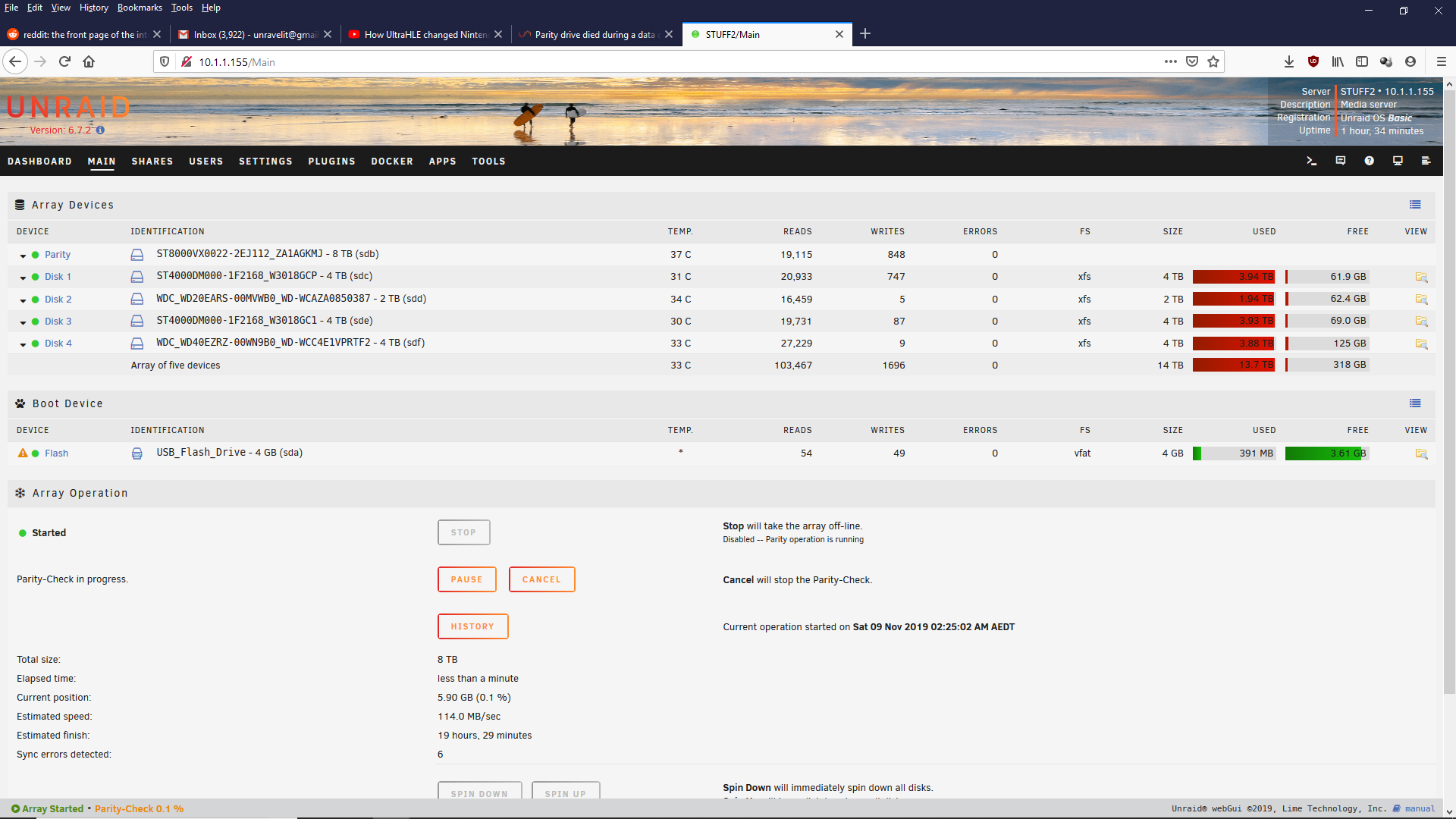

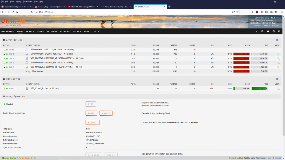

Thanks again for your help so far. All the drives came back looking right... and a non-write parity check is under way (and will take the normal ~19 hrs).
All my disks are badly over filled, I know you are not meant to go over ~90 percent, but times are desperate, hence the 8tb upgrade :D
Awesome help!1675876365_Screenshot2019-11-0902_25_59.thumb.png.96705b14823bf8fd2adc51b7bef8e6c0.png
You might as well cancel and start a correcting check, since there are already a few errors, and they are expected after what happened.
