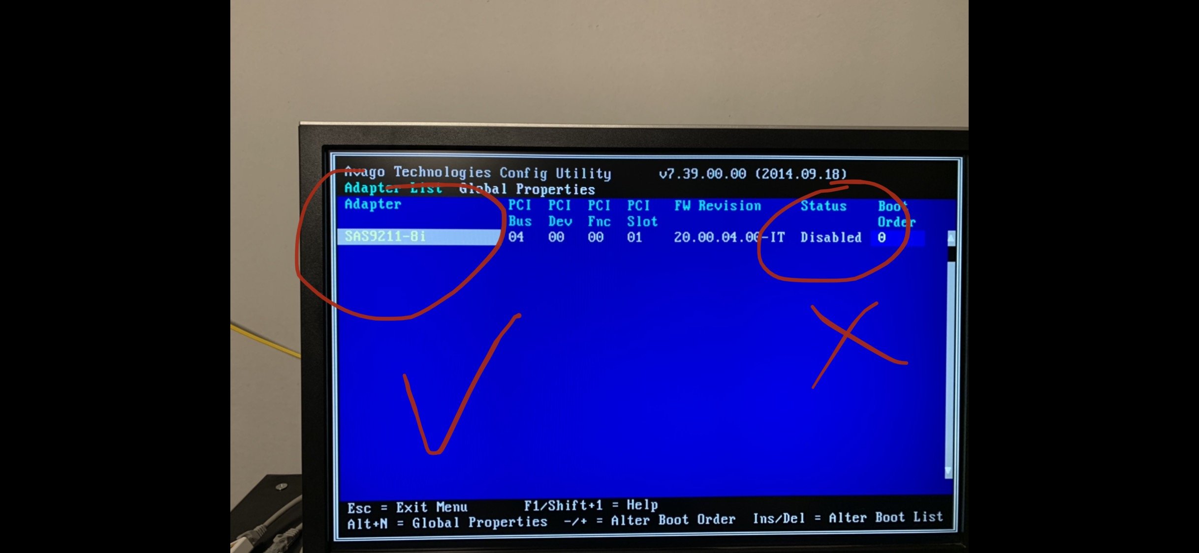

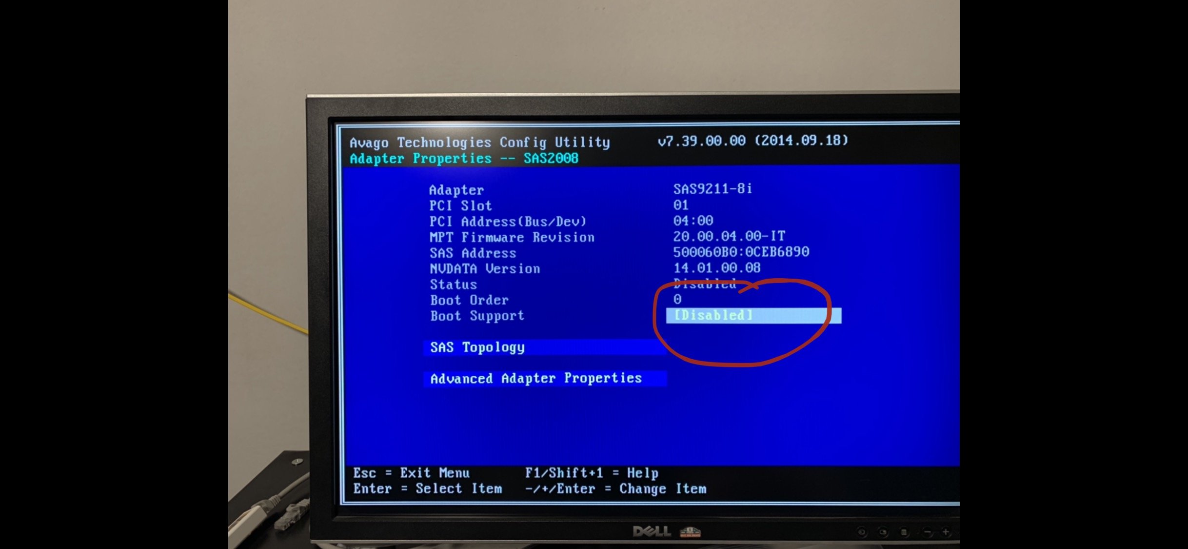

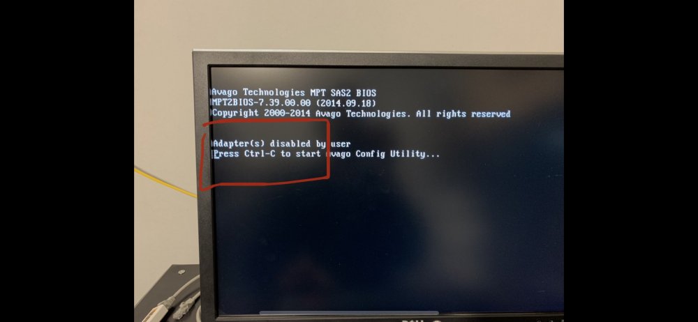

Hell Yeah!
I finally made it with Benson's methord .
Disable the SAS adapter by the ctrl-c
Great thanks to Benson!! love you guys amazing !

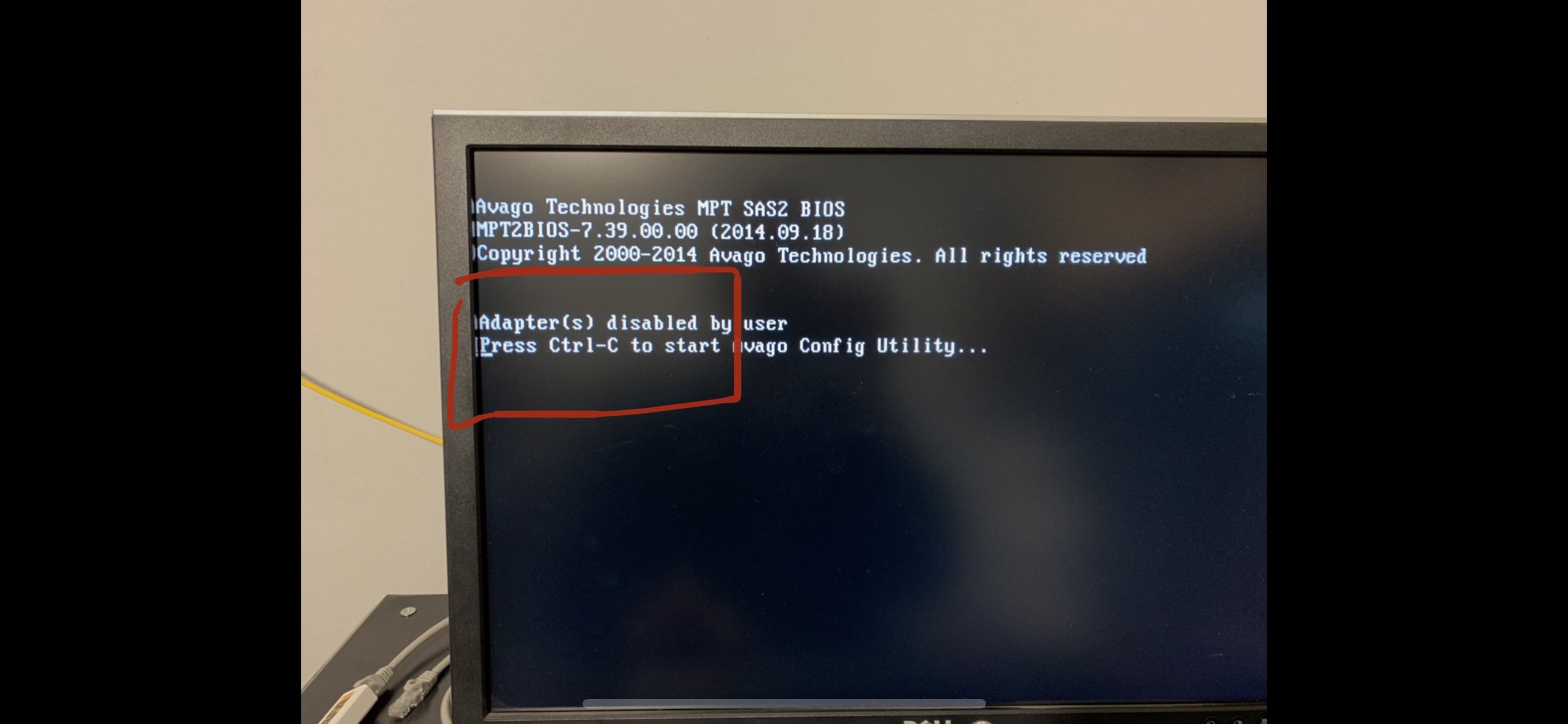

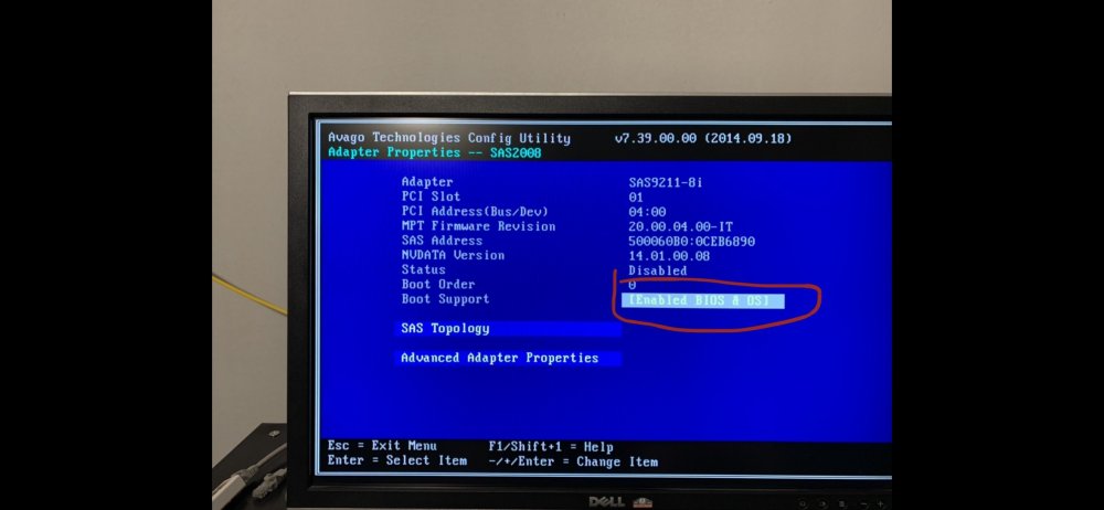

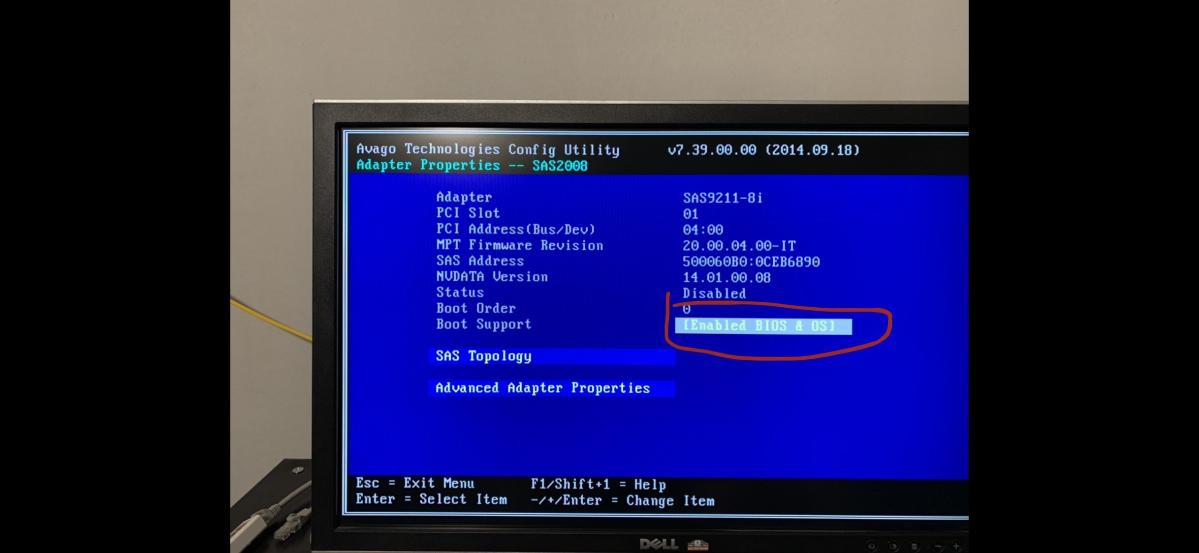

(picture below was after the success change to the boot ,so it might not be accurate .
just show the properate order to get things done .
