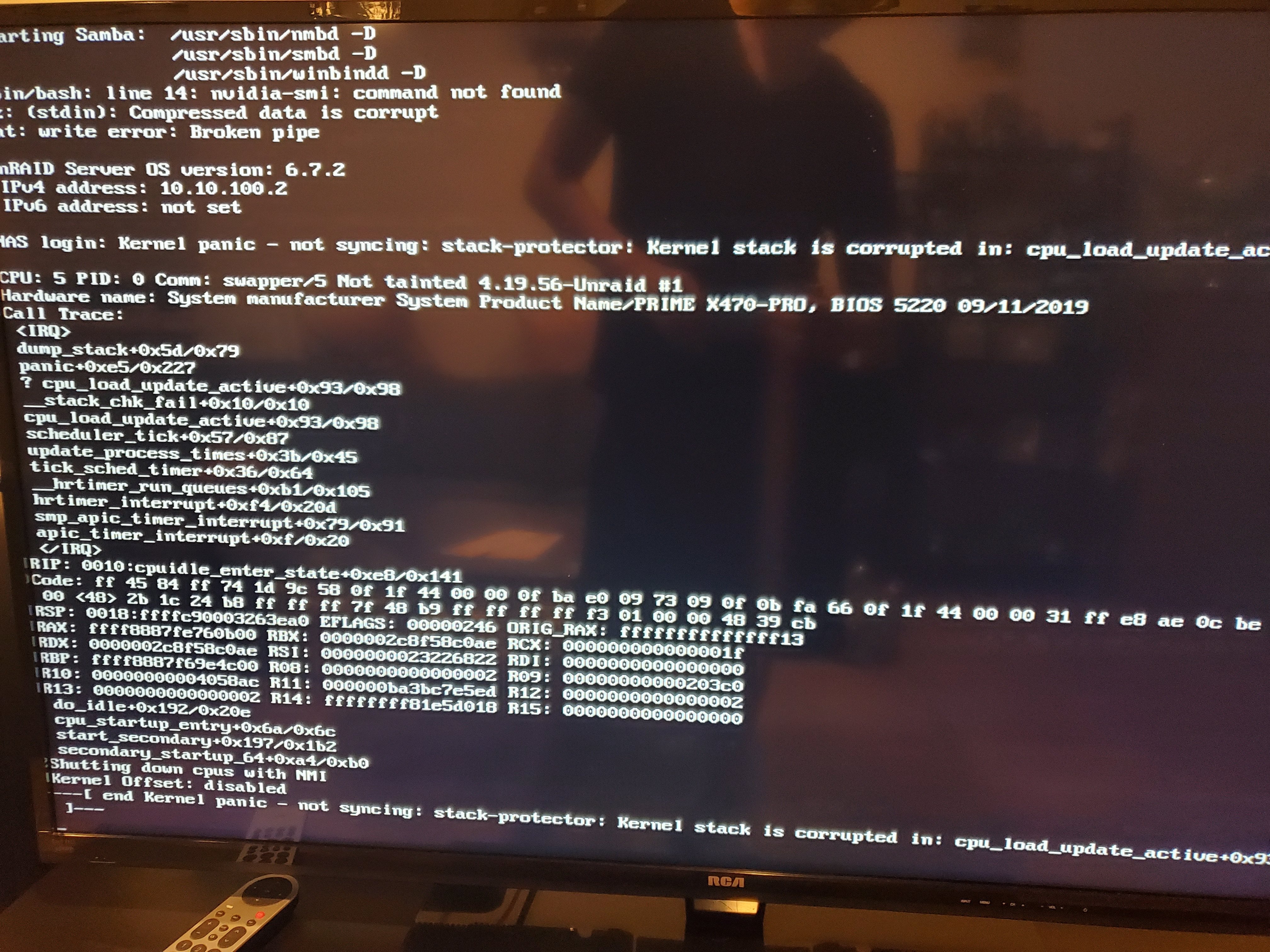

Hi I got it up now but now it showing me "kernel panic - not syncing: stack-protector: Kernel stack is corrupted in: cpu_load_update_ative+0x93/0x98"
I try to reinstall os on usb and i got up for like 2 mins and then that error show up.
From the screen shot it looks like your boot flash is corrupt. What is that reference to nvidia-smi in line 4? Are you not using stock Unraid? I suggest you do until you get the problem fixed.

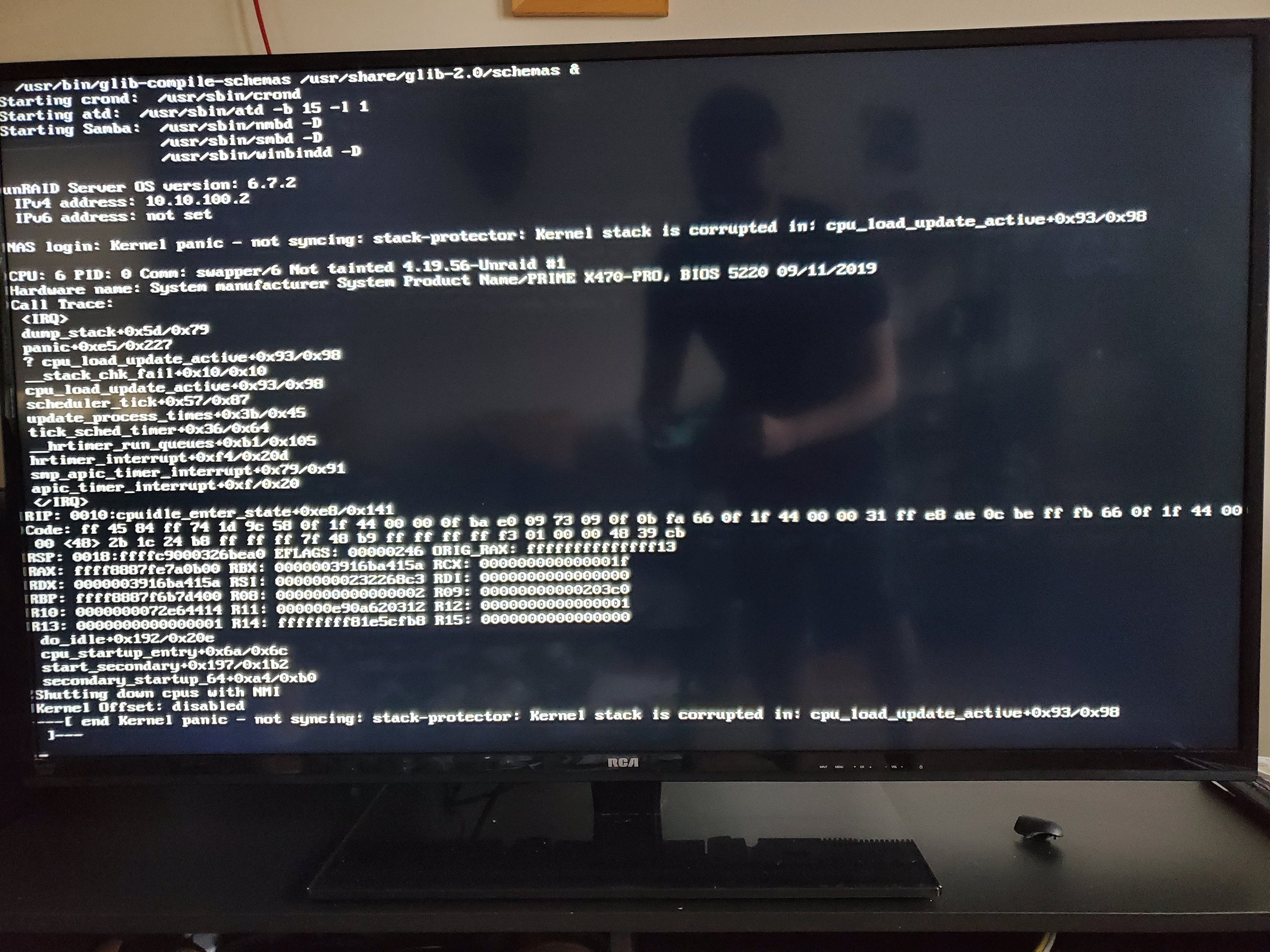

I reinstalled stock unraid and copy the config folder back, it run log in to the web through ip and up to like 2 mins then that error occurred

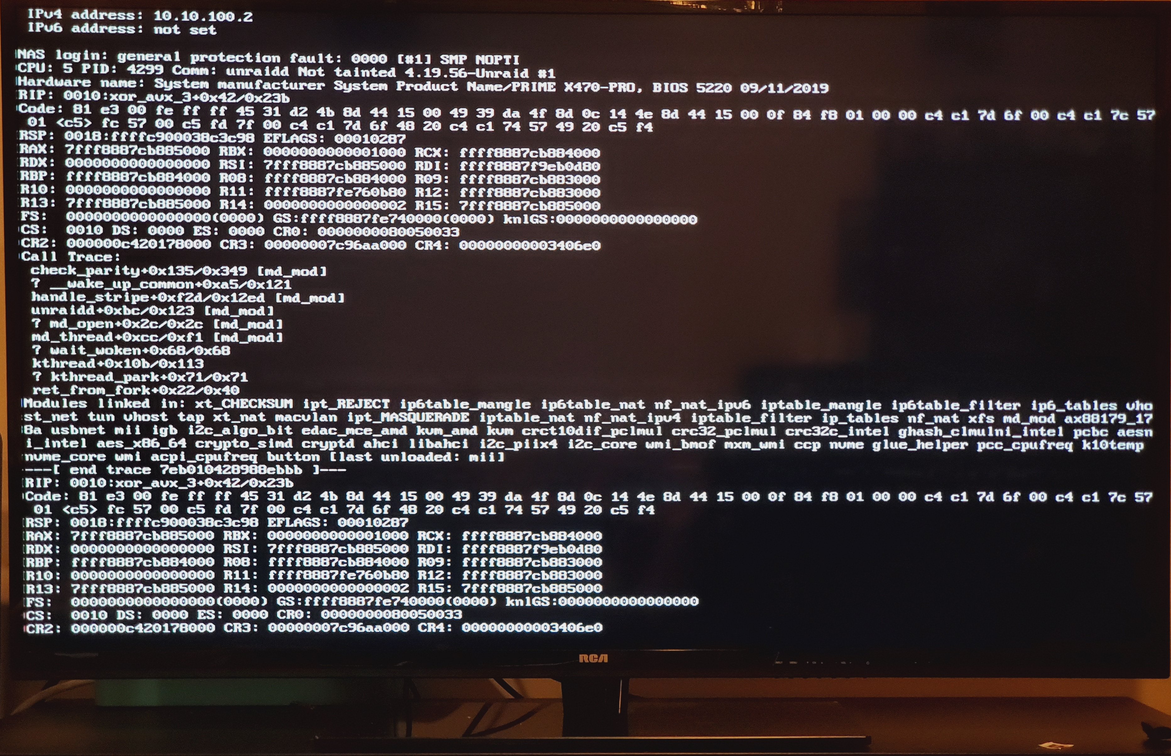

I did this like 5 times already and there is this error now.
Can you try making the USB stick one more time but this time don't copy your config back onto it. I'd like to see what happens with a completely vanilla installation. Your latest screenshot looks like the array is set to autostart. Maybe there's corruption in your config folder. I'd like to see a clean boot all the way to the login prompt. If you get to the login prompt, login as root (no password), then type "diagnostics", wait for it to finish then type "poweroff". Don't try to do anything else. It should shut down cleanly. Then move the USB stick to a PC and copy the diagnostic zip file from the logs folder on the stick. Post the zip file.

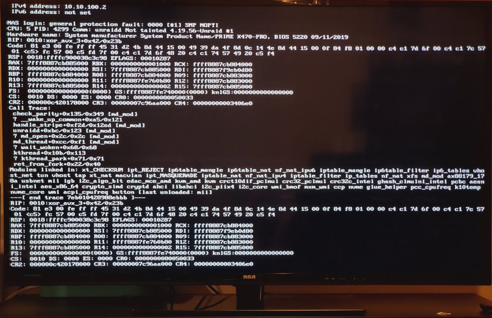

I speak to quick it happen again. Could this be my usb?
