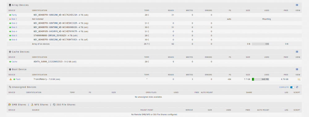

Today I discovered a fault disk in my system, as I've done in the past, I replaced it with a new drive.  I installed the new drive and now I can't past "array starting ... mounting disks".
I've tried with a different drive, same problem. I've even tried starting the array without the drive installed and it still tries to mount the EMPTY drive (see attached picture).
The faulty drive was BTRFS, I've tried selecting BTRFS, XFS and AUTO for the new drive but nothing works.
I've been at this for hours now and I'm beyond extremely frustrated.
That's normal since it's mounting the emulated disk.
Btrfs disks can take several seconds to mount, an emulated btrfs disk can take much longer since data is being reconstructed from all the other disks, I don't see any error on the log, have you waited a few minutes to see if it's just taking a longer time than usual as expected?
