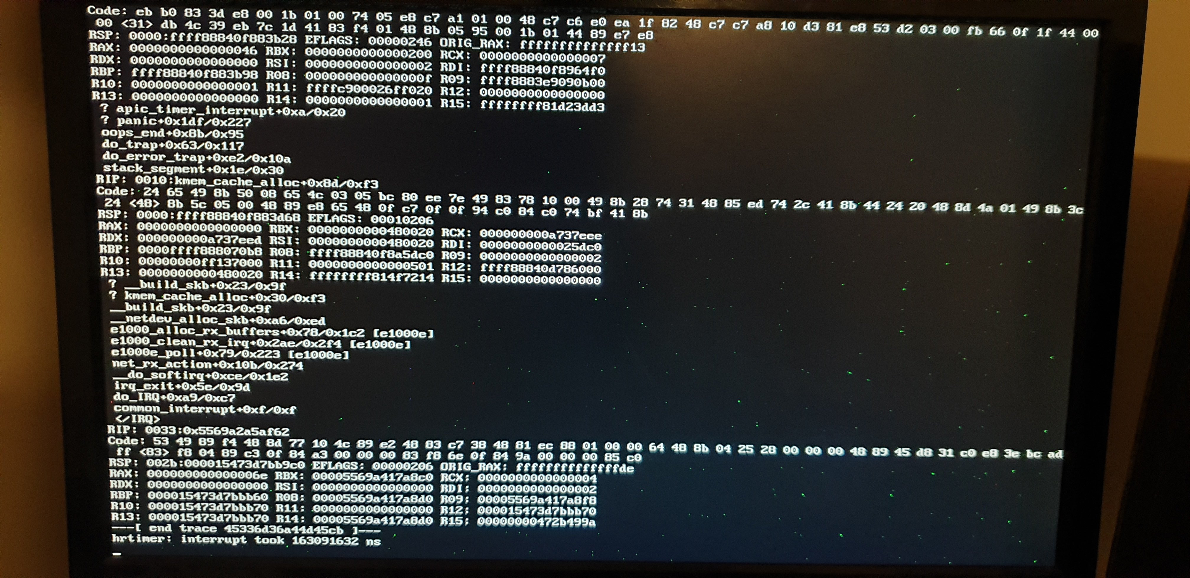

I seem to have a big problem with my server the last month or so. Problems started after getting it back online afte 5 months, it would crash about 5 min in after a cold boot, server was running in dual channel memory during the crash (worked find before). After removing channel 2 of the memory, server was working as normal.

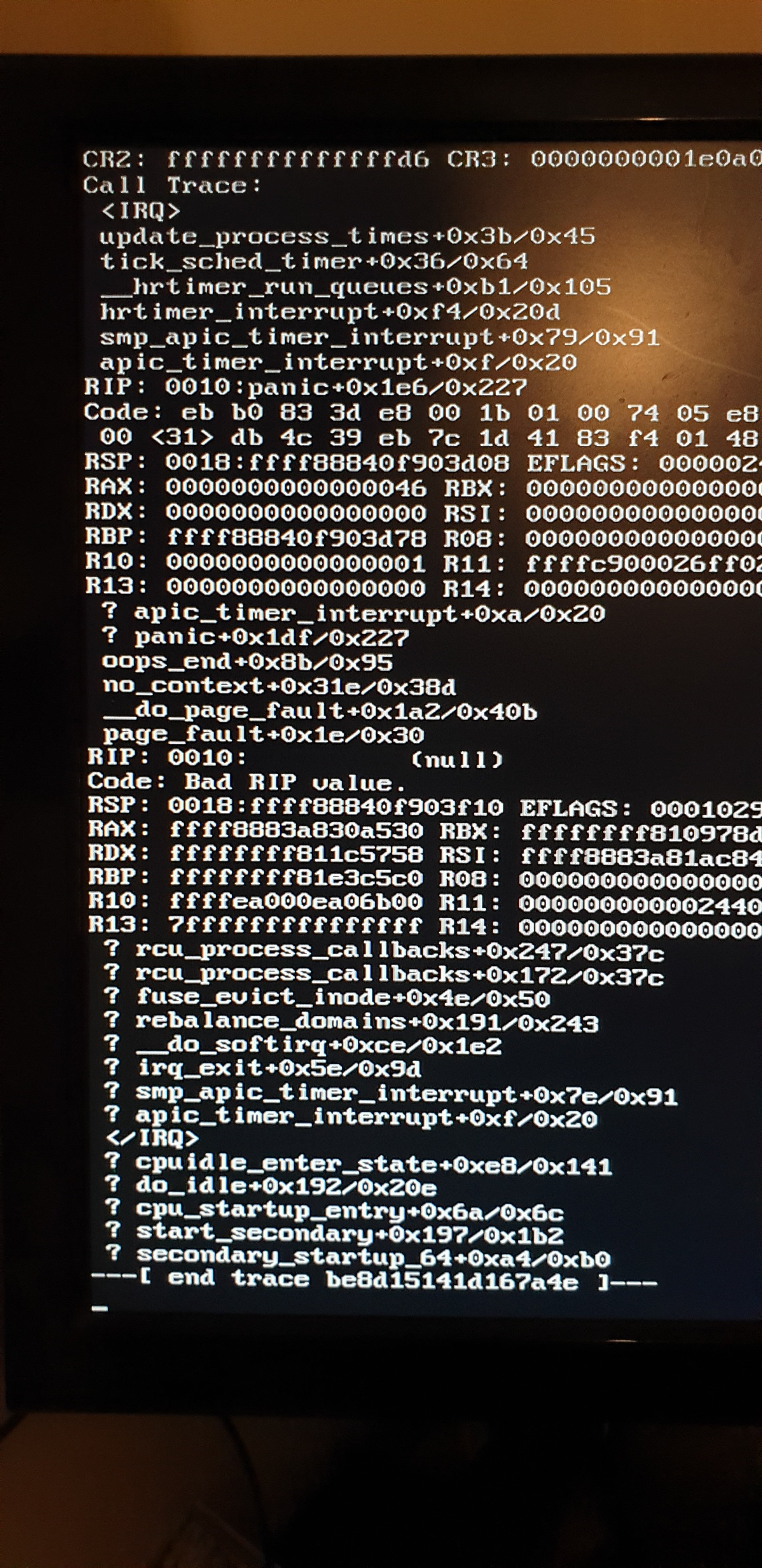

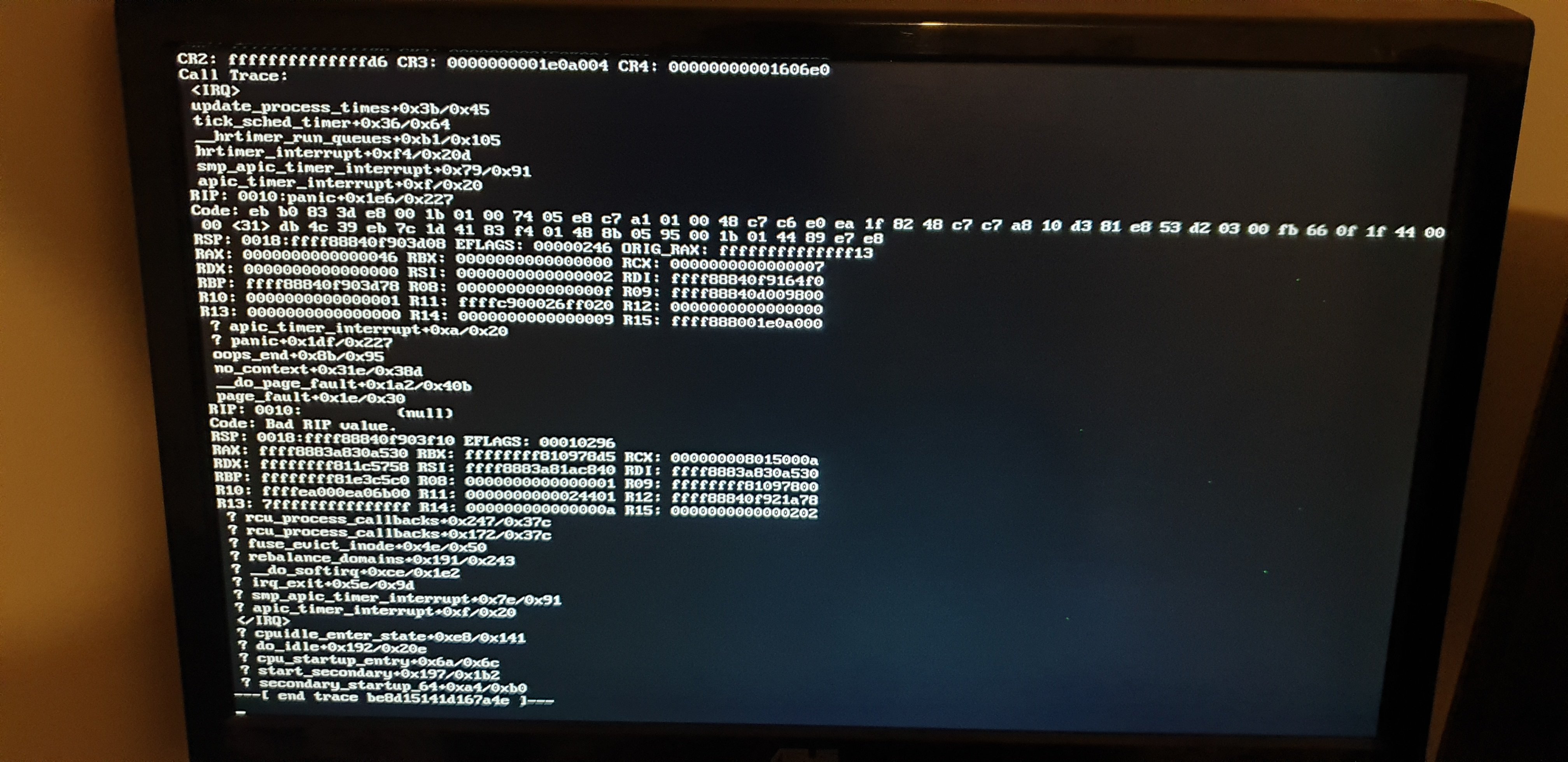

But now, I was doing a well over time computer backup to the server, and get the same crash again, I was able to take some photos of what was on the screen at the time, hope someone is able to help me out
(Photo 1 is of the first crash. Photo 2 and 3 plate from a restart from the first crash)
