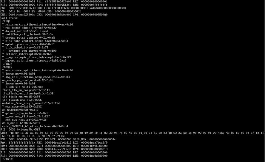

  1. Just want to start by saying that the unraid server is running under proxmox with GPU and Raid card passed through to the vm. I went to check up on my server today after changing a GPU allocation, when I looked at the console output I was greeted with a strange log on the screen I hope there are some people out there that are able to look at the screen log and to identify what could make this happen. The info fo the VM is listed below #Unraid file server agent: 1,fstrim_cloned_disks=1 balloon: 0 bios: ovmf boot: order=usb0;net0 cores: 8 cpu: host (AMD Threadripper 1950X) efidisk0: sata-speed:101/vm-101-disk-0.qcow2,efitype=4m,pre-enrolled-keys=1,size=528K hostpci0: 0000:44:00,pcie=1,romfile=1080ti.bin (GPU) hostpci1: 0000:09:00,pcie=1 (raid card) hotplug: 0 machine: pc-q35-6.2 memory: 24576 meta: creation-qemu=6.2.0,ctime=1670216047 name: Unraid net0: e1000= *redacted*,bridge=vmbr0,firewall=1 numa: 0 onboot: 1 ostype: other scsihw: virtio-scsi-pci smbios1: uuid=*redacted* sockets: 1 startup: order=2,up=120 tablet: 1 tags: server usb0: host=18a5:0302 (unraid USB key) usb1: host=1c6b:a222 (USB dvd player) usb2: host=1-9.4 vga: qxl vmgenid: *redacted* Thanks in advanced for the help

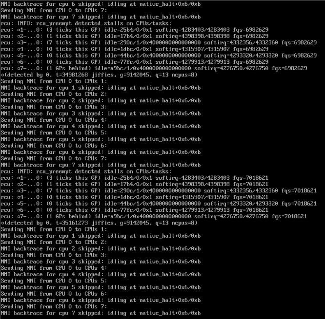

  2. i am running my unraid server as a VM inside proxmox with a HBA card passed through to it. After preforming an update on proxmox, i am receiving many kernel panics after having the server up for 3 days. I have attached a screenshot of the latest system crash, not sure if this will help with anything. any ideas of what could be the cause of the problem would be a big help

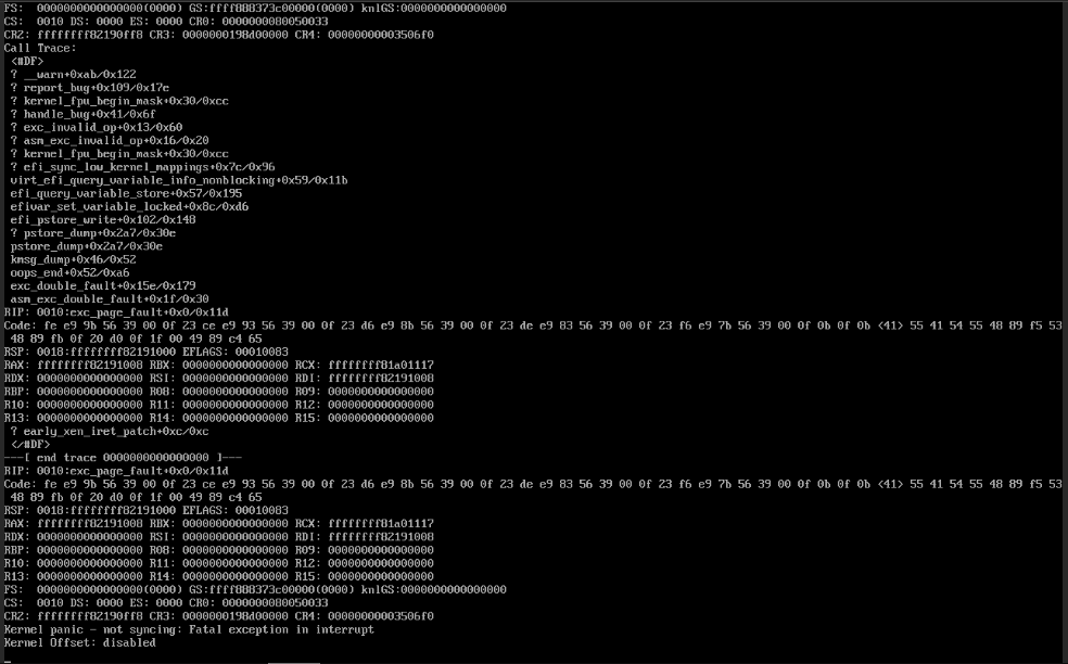

  10. I have just updated my server to the new RC3 build, after the reboot it was taking a long time to become available on the network. when i turned on the monitor for the server i am getting a kernel panic. i am getting this with every restart both in normal and safe mode. hope i am not the first with this problem
