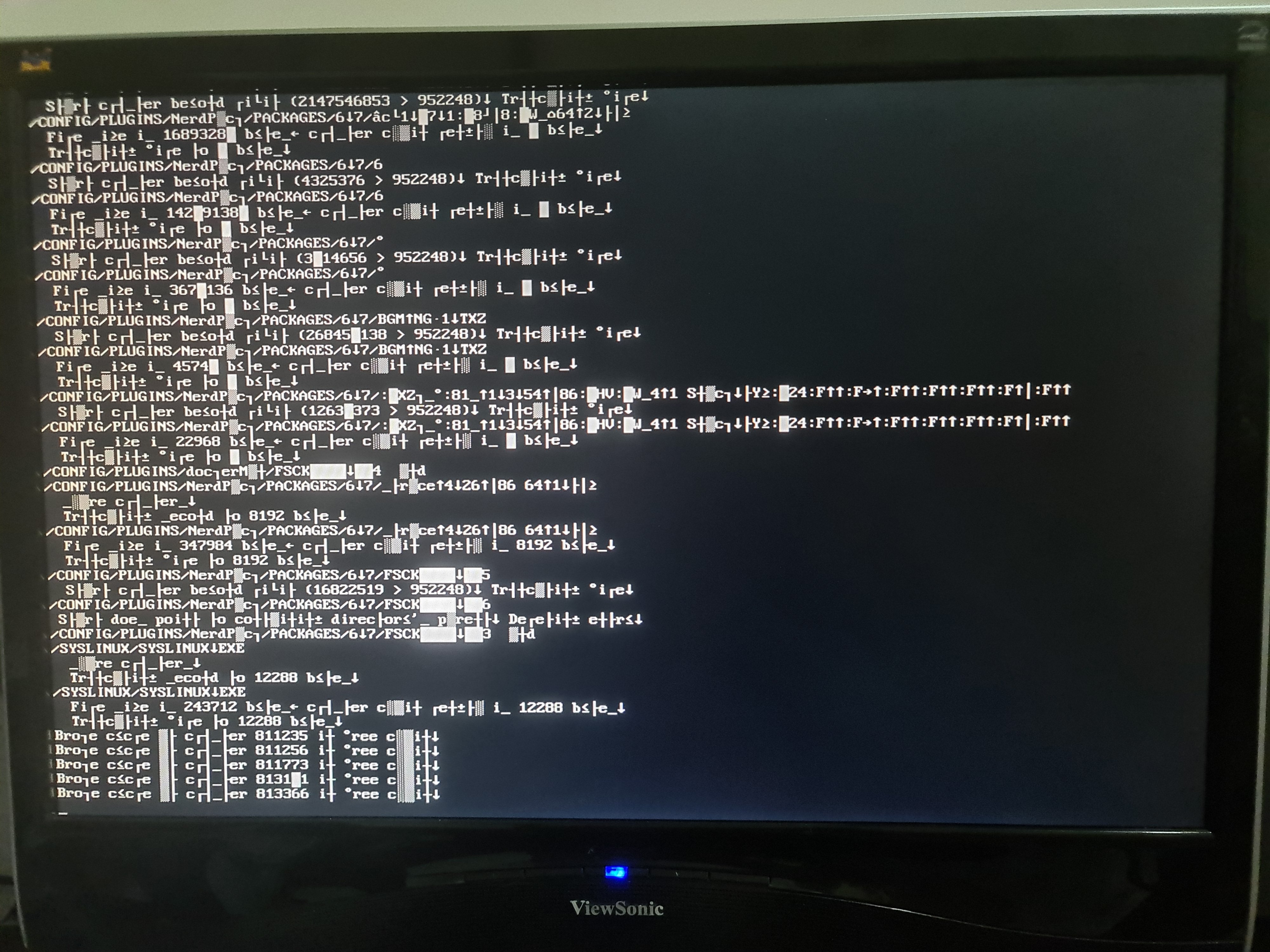

I am trying to get a pcie vga card and a sata raid card working on my computer. I know the video card is in good working order and the raid card is new, when I boot the computer, bios doesn't detect the raid card but vga card works fine, when booting into unraid, video output is all a mess
Am I looking at faulty pcie lanes or just some type of bios not configured properly

Do you have another GPU (or if the CPU includes a GPU) you could try with? Also, does it start showing that right after booting Unraid or halfway through the boot?

So to update people on the problems. the usb drive was so badly corrupted that i was getting checksum errors on boot, when it did boot, drives were not in a bool, and drives that were originally reporting fine had errors. I was able to recover the unraid usb drive and everything OS wise is working fine. about the Adaptec 71605, i don't know what i am doing wrong, on system boot i do not get any bios reading from the card. I have also put in a rocket RAID 2720, both cards have a HDD connected to them and i get no readings from them.
