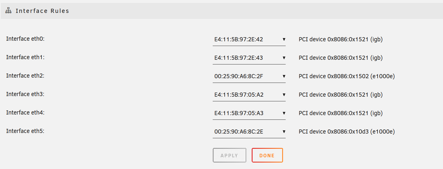

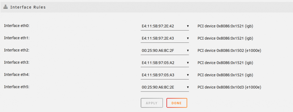

Simply replacing the existing cards should work, but you may need/want to adjust interface assignments. I.e. define which interface is eth0, etc...
Is that done in the network-rules.cfg?
You can make adjustments in the GUI under Network Rules, this subsequently updates the .cfg file.
A reboot is required to make the new assignments effective.
Really not trying to play dumb but i dont see Network Rules anywhere.
I think i just found it
Edited by Scott Harkless
Sorry my bad, it is indeed "Interface Rules"
Note: these rules will be updated after the new interfaces are added (and old ones removed) and the system is started (it requires discovery of changes)
Edited by bonienl
