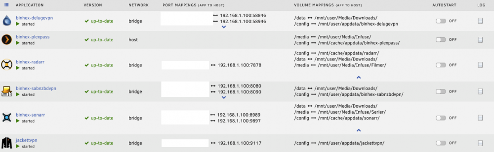

Here is a screenshot of my volume mappings pr. docker.
According to your diagnostic and "df", You do not have a cache disk, why are you using /mnt/cache/ in your mappings?
That could definitely cause problems as without a cache disk /mnt/cache will be in RAM.
