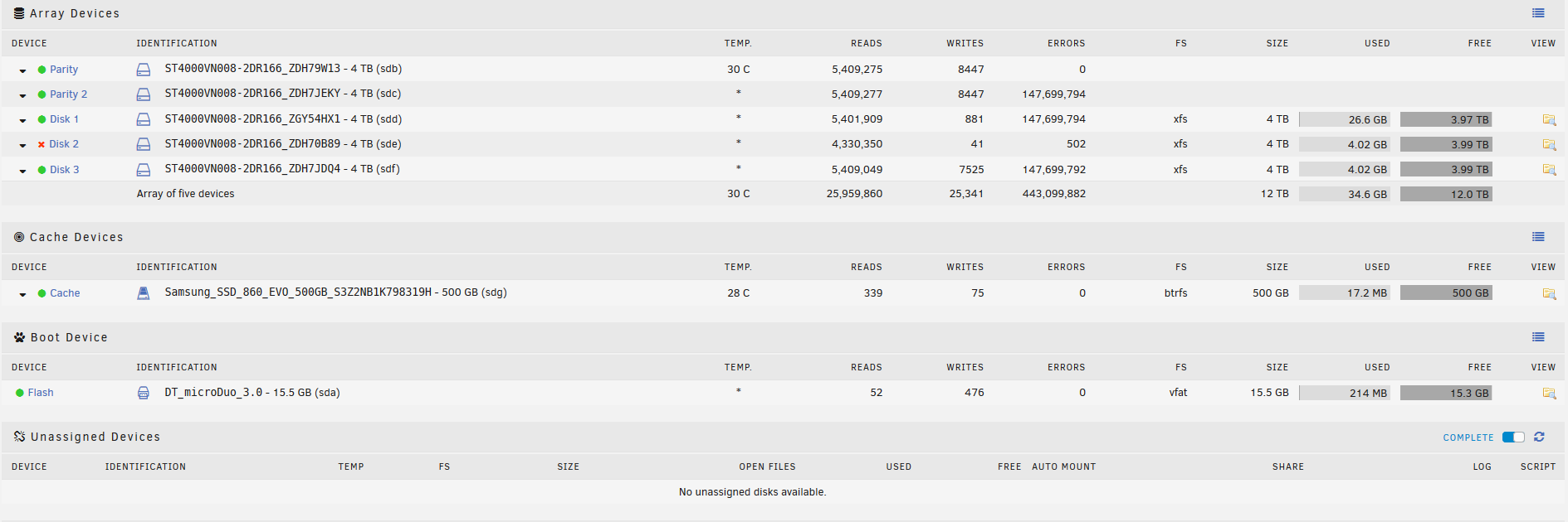

After installing unraid (first time user) disk 2 had a bad file system and it's 4GB capacity was not counted in the array.
Parity read/check had 968081081 errors after 1h 3m.
After a reboot, I formatted disk 2 and it became part of the array, and the array capacity increased to 12 TB.
Everything looked ok.
Then I tried to run a new parity-check, which I canceled after 160276490 errors, and because disk 2 status is now "Device is disabled, contents emulated".
Searched the forum and did a diagnostics test that gave me the following info on disk 2:

On mobile now so haven't looked at Diagnostics yet.
Bad connections are much more common than bad disks.
Check all connections, power and SATA, both ends, including any power splitters.
Then post new Diagnostics.
Don't use the onboard Marvell controller (4 grey ports), it's dropping disks, and they are known to do that, all 4 disks with errors are connected there.

  1. Stop the array
  2. Set disk 2 to no device
  3. Start the array
  4. Stop the array
  5. Set disk 2 to...
  6. Start the array
  7. The disk will rebuild.
Followed this to get the drive back into the array.
