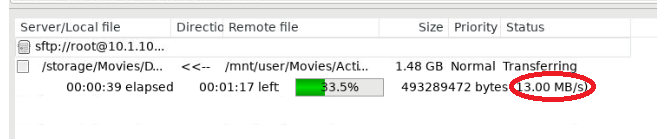

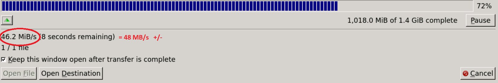

I can't speak to Krusader as I haven't used it. Dolphin seems to greatly out perform Filezilla on my rig. I've done some testing and something is limiting my Filezilla to about 13MB/s (see image) this test is moving data within unraid from one share to another, I'm not sure why it isn't faster. Honestly I only use it out of laziness, if I'm already moving data from my seedbox to unraid with Filezilla then I will also use it to move internal folders as needed rather than opening dolphin. Note that internal moves are pretty rare for me... Next I tried Dolphin which is what I used to load my array for the first time, running the same exact test I used with Filezilla I got about 48MB/s. I'd say that's an expected speed considering my rig is really old. I may be wrong but I'd think you should get somewhere in the same neighborhood through USB 2.0, while not the 100 MB/s you're looking for it's better than the 15-20 you seem to be getting now.
