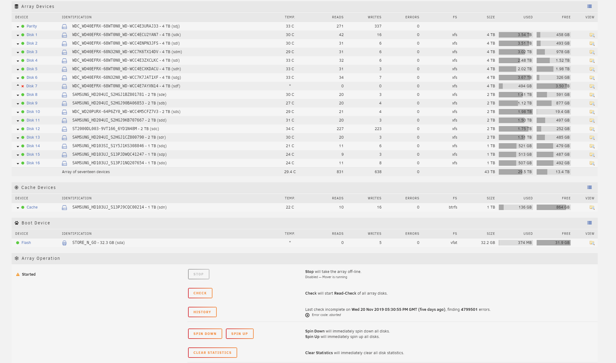

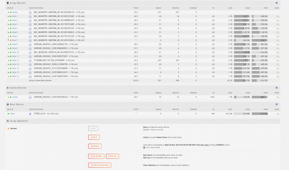

I'd appreciate some guidance please on the following problem.
I've got an unmountable disk 7.  The array runs ok with the contents emulated....
It has happened to this disk previously and I assumed it was a bad disk, so I replaced it and rebuilt the array with no problems.
But, unable to find any errors with it through a SMART report, it was reinstalled as a new additional disk and all was good for a few days, but the same problem has happened again.

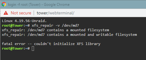

Trying some self help from a previous forum post seemingly very similar to mine, I ran xfs repair through the console. It didn't sort the problem and suggested I strip the log with -L flag and re-run. It hasn't helped.
Confusingly the log suggests it's md6 with the problem. so I tried the same again with the same result.
If I use Unbalance to scatter the (emulated) contents of disk 7 to the rest of the array, can I assume that I can then safely remove disk 7 from the array completely and shrink it?
Thank you in advance.
Paul
Unraid.png.ad05161c8532a1267974e19ed6f5021e.pngmain.thumb.png.ab0174412e3063d87b13defdfa4b7a98.pngsyslog.txt
Hopefully the attached pics/log are self explanatory.

Disk is not unmountable, it's disabled, two different things, unmountable is usually a corrupt filesystem, a disk gets disabled when there's a write error, sometimes cable/connection related, sometimes a failing disk, that disk is showing UNC @ LBA erros, i.e., bad sectors, and if it's not the first time it gets disabled you might want to consider replacing it.
Also, disk6 has filesystem corruption you want to check that, with the array in maintenance mode:
https://wiki.unraid.net/Check_Disk_Filesystems
