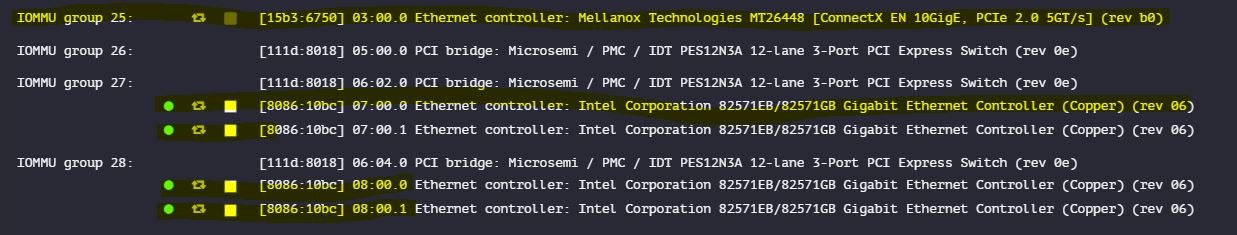

IOMMU not splitting Mellanox dual NIC into it's individual components?
Whereas my Intel Quad NIC has been split into 4 separate, selectable NICs...... My reason for asking is that I would like to allocate one of the Mellanox 10Gbe NICs to my pfsense VM and retain one for Unraid.......... Or, is that simply not possible? TIA Paul

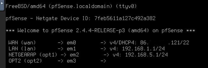

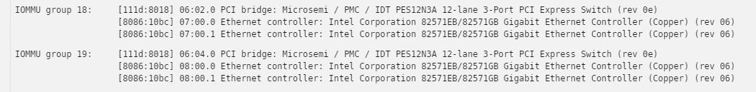

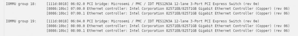

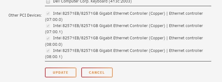

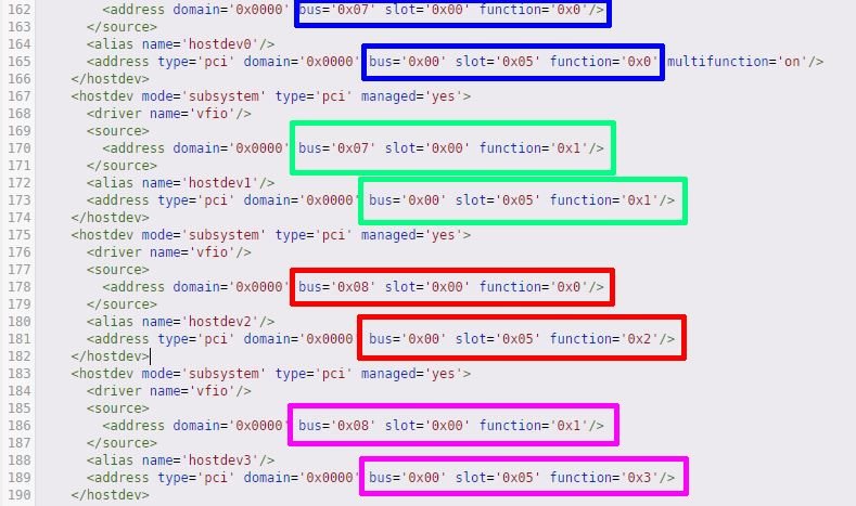

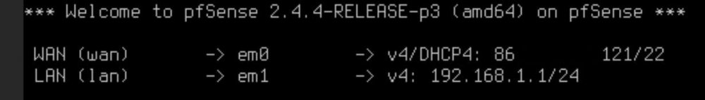

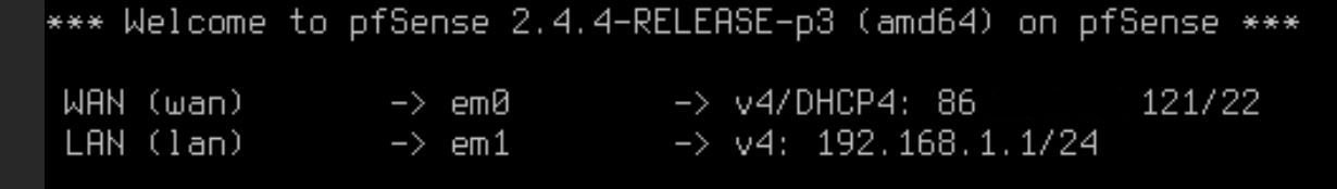

I too am thoroughly frustrated with this!! Folks..... Can I ask you to have a look at my details and see what I have missed please? Like others, I have the 4 Nic Intel card, which pfSense only passes the first NIC through when left to its normal setup.... Following lots of editing tips from this thread, and others, I've arrived here with two NICs in play..... but for the life of me, I cant get the second pair up....... So, I stubbed the NICs... Succesfully arrived in the VM; Edited the XML; End result; I've also tried various combinations of bus/slot/function for that second pair..... all to no avail.......... If I was charging myself by the hour for the time spent on this...... I'd be very, very broke!

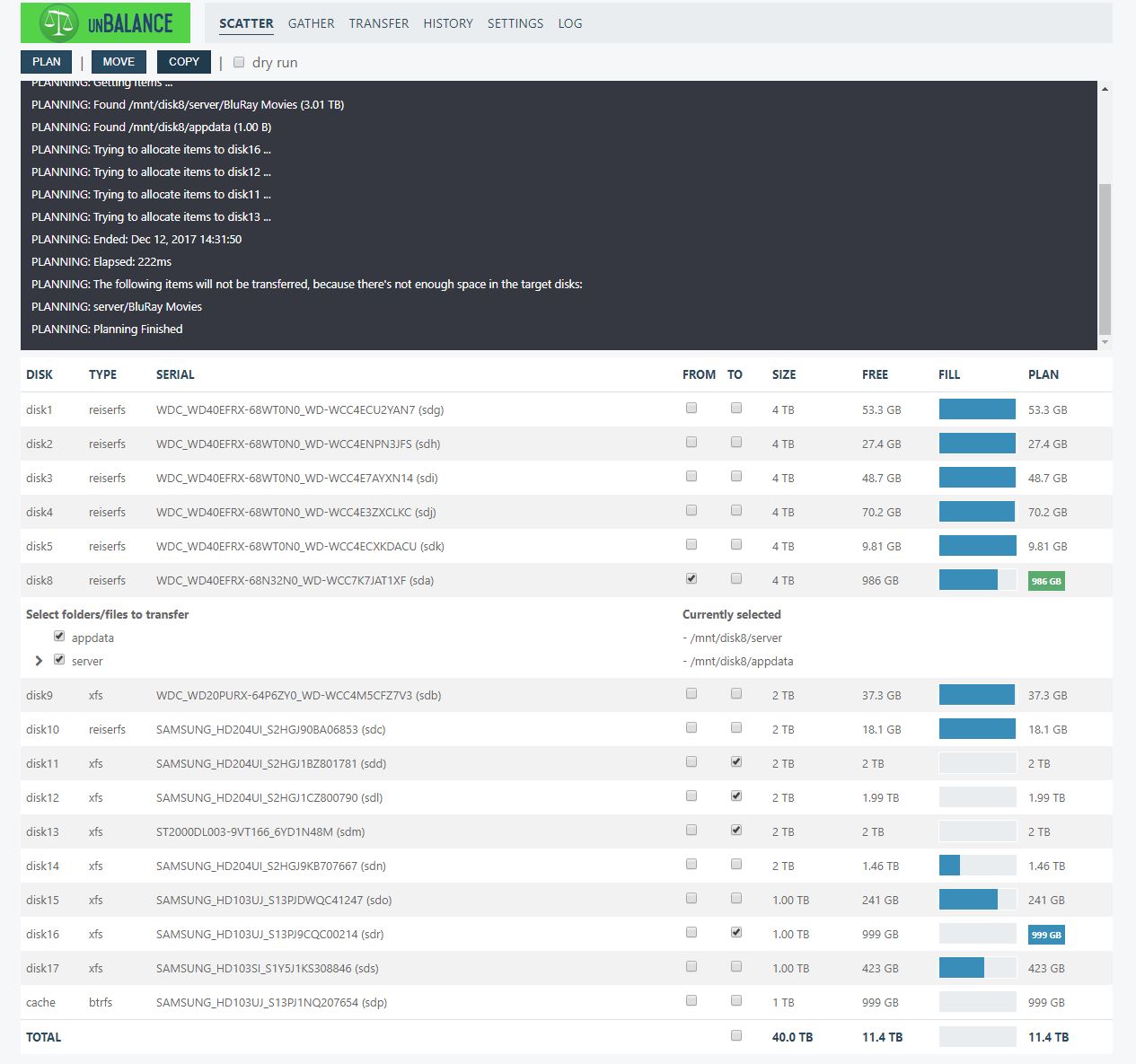

Hi, I hope you can help with the following problem...... I must be missing something fundamental here... I'm trying to empty Disc 8 (4TB) with a view to re-formatting it............. As you can see from the graphic, I've got 7TB of empty disc space selected, but it says I haven't got enough space. What am I missing please? Regards, Paul
