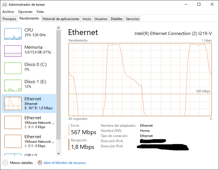

The problem is, when I copy a bunch of files from Windows 10 1909 to unraid shared folder on WD RED disks it goes perfectly at 112 MB/s, but when it finish to copy one file and starts the next one, it stops like 10 seconds and then continues at 112 MB/s. On the unRAID Dashboard I can see, sometimes one core is at 100%, but not allways

It happens all the time, you can see the Windows 10 task manager statistics
