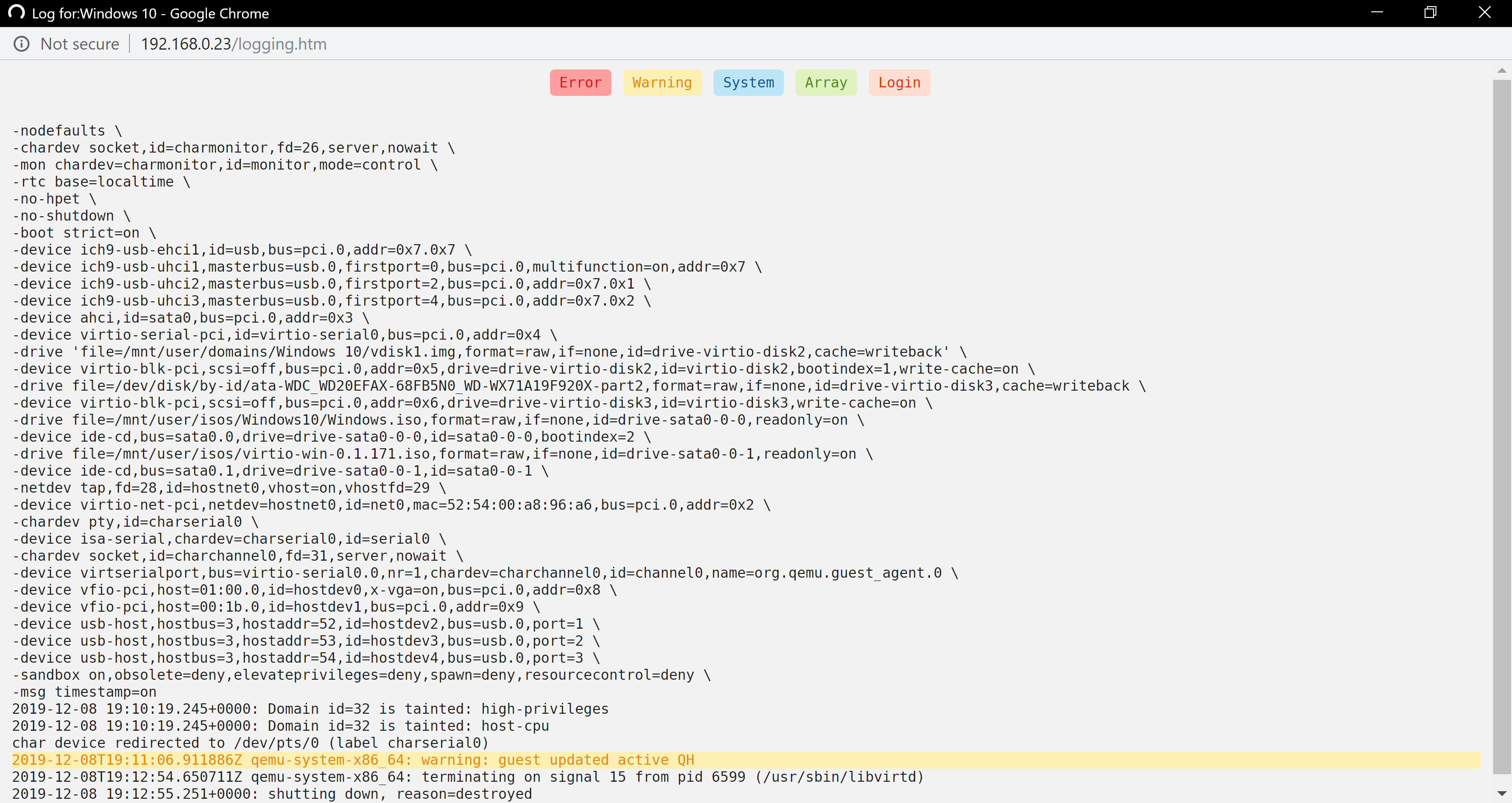

Attached is the log for my VM that I'm having this issues with.
As a start, you should post a set of diagnostics before you reboot the server
Was able to replicate the issue and get the files.
tower-diagnostics-20191208-2027.zip
Update from explanation in first post.
When the screen goes black it's losing the video signal. Tried with an other monitor after the screen went black and it was not even detecting an input from the cable.
