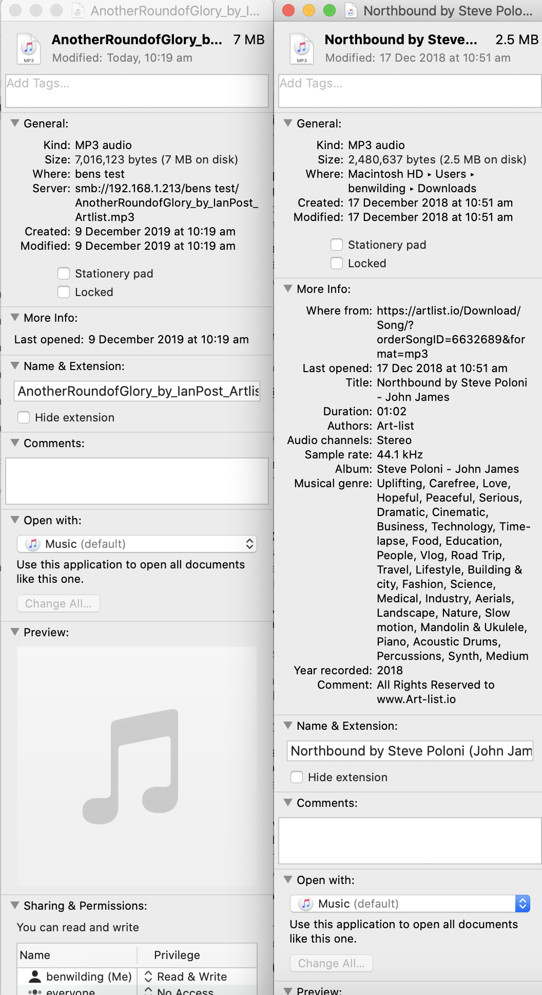

I've setup a test server running the evaluation version - everything is looking great so far!

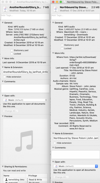

The only problem I've come across is the share doesn't appear to preserve the file metadata in macOS Catalina once copied to the server (see attached image) - the finder get info screen on the left is after the file has been copied to the share, and the one on the right is before it's been copied.
I've setup both a SMB and AFP share and tried it on both - is this something that is supported or am I doing something wrong here?

Edit: I've just realised that the screenshot is showing two different files - however this is exactly what happens when the file has been copied to the network - all the info under the more info: display disappears.

Type way MacOS attaches the metadata I’m not 100% sure, but it seems to be linked to the attributes of the file rather than contained within the file itself.
The reason I say this is purely speculative, however I thought that information like EXIF data are stored within the contents of the file itself - eg. in the header of the file.
If I copy the file to a SMB share and read the metadata from it, it appears when it’s sitting on a Mac server, so it doesn’t seem to be a limitation of the SMB protocol.
The screenshots I sent were using the finder - which is the equivalent view of right clicking in Windows Explorer and seeing the file properties.
