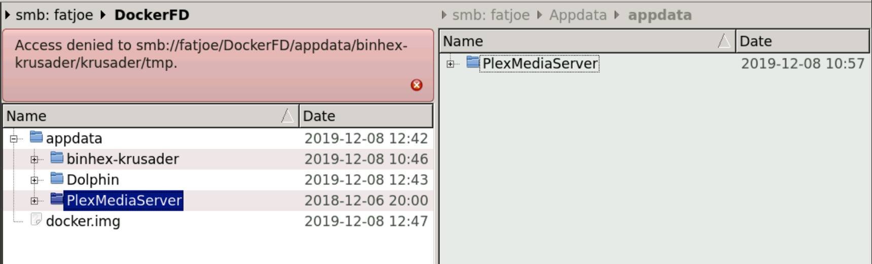

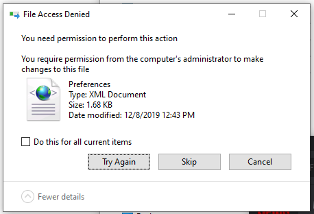

I'm trying to move my Plex docker from my unassigned drive to my raided cache drives but i keep getting permission errors. so far ive tried
1: setting up an SMB share in unassigned drives
2: redone the permissions using install Fix Common Problems Plugin, then hit Tools - Docker Safe New Permissions
but i'm still unable to copy the files off, i can remove, copy, move everything thats on the unraid array just not unassigned drives.
3: installed Dolphin docker but even with that i cant copy the files nor change the permissions.
image.png.6ffdc3da28ff7c9f6ee1beb572b67b18.png78916533_2925013450864406_1573214694817136640_o.thumb.jpg.af668759600a624d333f74e25e2ebea4.jpg

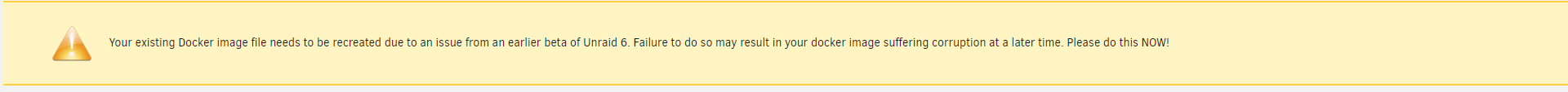

could never figure out how to move the files but was able to backup and restore it with "CA Backup / Restore Appdata" got everything repointed but now i have this error.
"Your existing Docker image file needs to be recreated due to an issue from an earlier beta of Unraid 6. Failure to do so may result in your docker image suffering corruption at a later time. Please do this NOW!"

You would do it directly via Krusader after mapping say /UNASSIGNED to /mnt/disks/...
Just recreate it then and don't worry about it.  https://forums.unraid.net/topic/57181-docker-faq/#comment-564309
will do.. a lil reserved having to redo all the dockers
Just use the Previous Apps feature on the Apps page. It will automatically use the settings you had before. Since you apparently intend to change a mapping just edit that one before submitting it. Everything else will be just as before.
wow thx
never knew it was there
