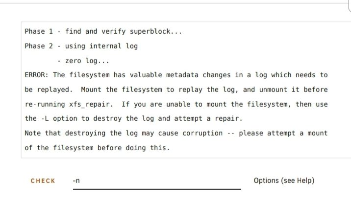

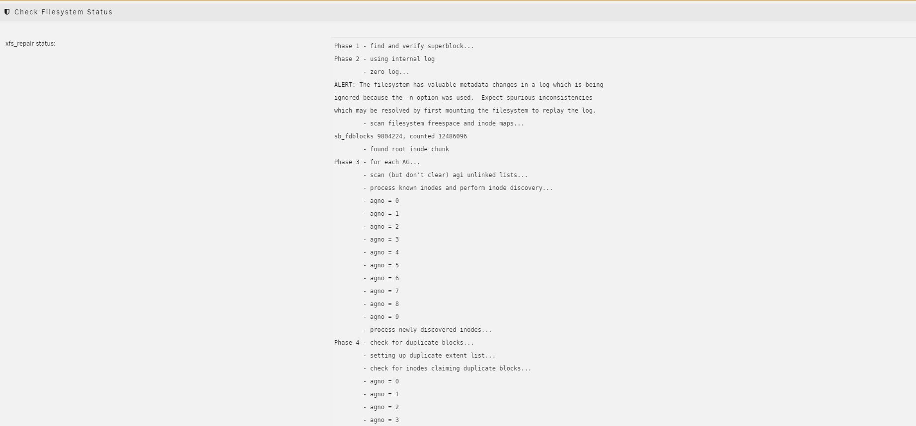

Done the check. This is what its showing.

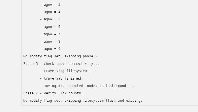

Run again without -n or nothing will be done.
This now. What do i do after this guys.
