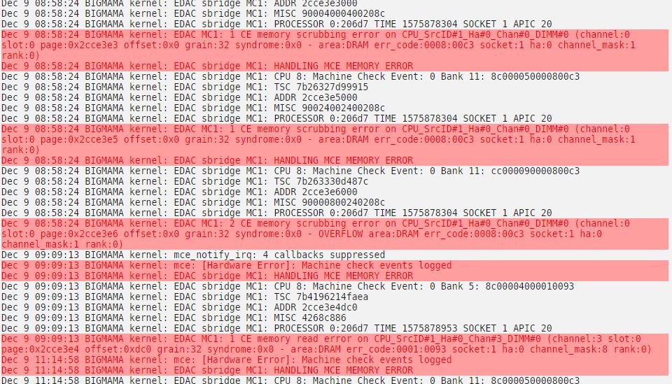

Hi Guys,
I Am a new user on the UNRAID platform an since a couple of weeks a receive hardware errors. Can anyone help me how to troubleshoot. I have installed 256 GB DDR3 ECC RAM but receive some errors in my log. I have no idea what to do to solve this issue.
Thanks
Tom
Those are probably due to bad DIMM. You might want to remove one stick at a time and see which one causes the error to go away.
As testdasi said, it is likely a bad DIMM. I just had to deal with this myself and it isn't fun.
Best thing to do would to run memtest86 with all memory installed until you start seeing memory errors. Once you see these errors, take a picture / write down where they occur (eg: test 2, test 3, etc..)  and how many. That way you only have to run up to those tests and not have to go through the entire testing to find the bad stick.
Once you've found out which test you seem to have failures at, remove all but the minimum amount of memory required by your system and then run the test past the test # you were previously getting errors at. Then you just swap one stick in at a time, retest up to the test # after and repeat until you find the bad stick.
After you've eliminated the last stick, run through the full memory test gambit to ensure everything checks out.
Been down this road recently.
OS would catch faults in 2 of the 12 sticks in the server, but memtest86 didn't.
Got replacement sticks, and no errors since.
also looks like you have a pair of 'em bad.

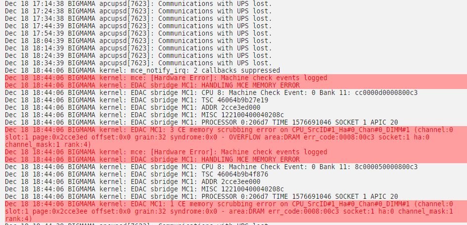

Also, this is exactly what the log is telling you.
A "CE memory read error" or "CE memory scrubbing error" is a "Correctable Error (CE)". It would be worse if you were getting "Uncorrectable Errors (UE)"
My concern is that you've merely turned off the memory scrubbing and whatnot, hiding the errors rather than fixing them.

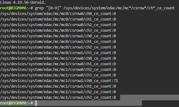

Today I receive again CE errors. So as ask I entered the following command in the command line. See pic1 for the results.
grep "[0-9]" /sys/devices/system/edac/mc/mc*/csrow*/ch*_ce_count
Today again error but I think I found the bad module. Just removed that bad one and test the machine for upcoming two days. Hopefully that will solve my UNRAID memory problems.
I change all my ram for new ram and it looks like my problems are resolved.
