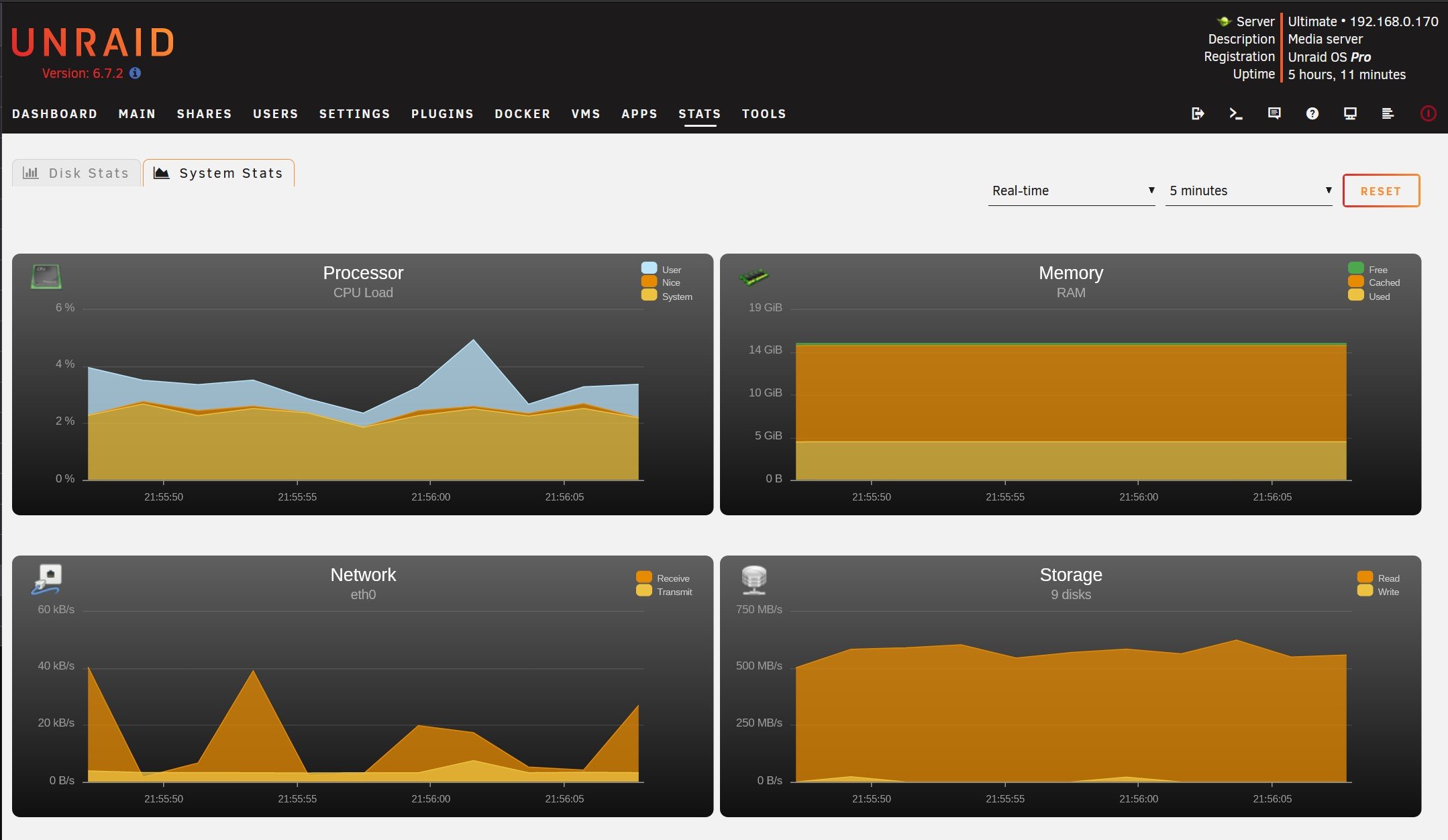

I can now confirm that the system will die when I run the mover. I am trying to move 2TB of data at a time to my unraid plex, and I think my system is running out of memory and just dies.  I also noticed that even without the mover running the system stats shows that almost all 16gb of memory is in use, see attachment. Is it normal for unraid to use all that memory essentially idling? I read a post talking about tip and tweaks that discuss changing vm.dirty_background_ratio and vm.dirty_ratio, but I have no idea what to set them at or even if I should be playing with these settings since it says don't change these if you don't understand them.
If I don't use the mover, I don't have any problems.
Any suggestions?

Unraid is linux, and linux will use free RAM for I/O buffering. All that space on the graph described as "Cached" in the legend, between "Used" and "Free" is just that I/O buffering, and completely normal.
