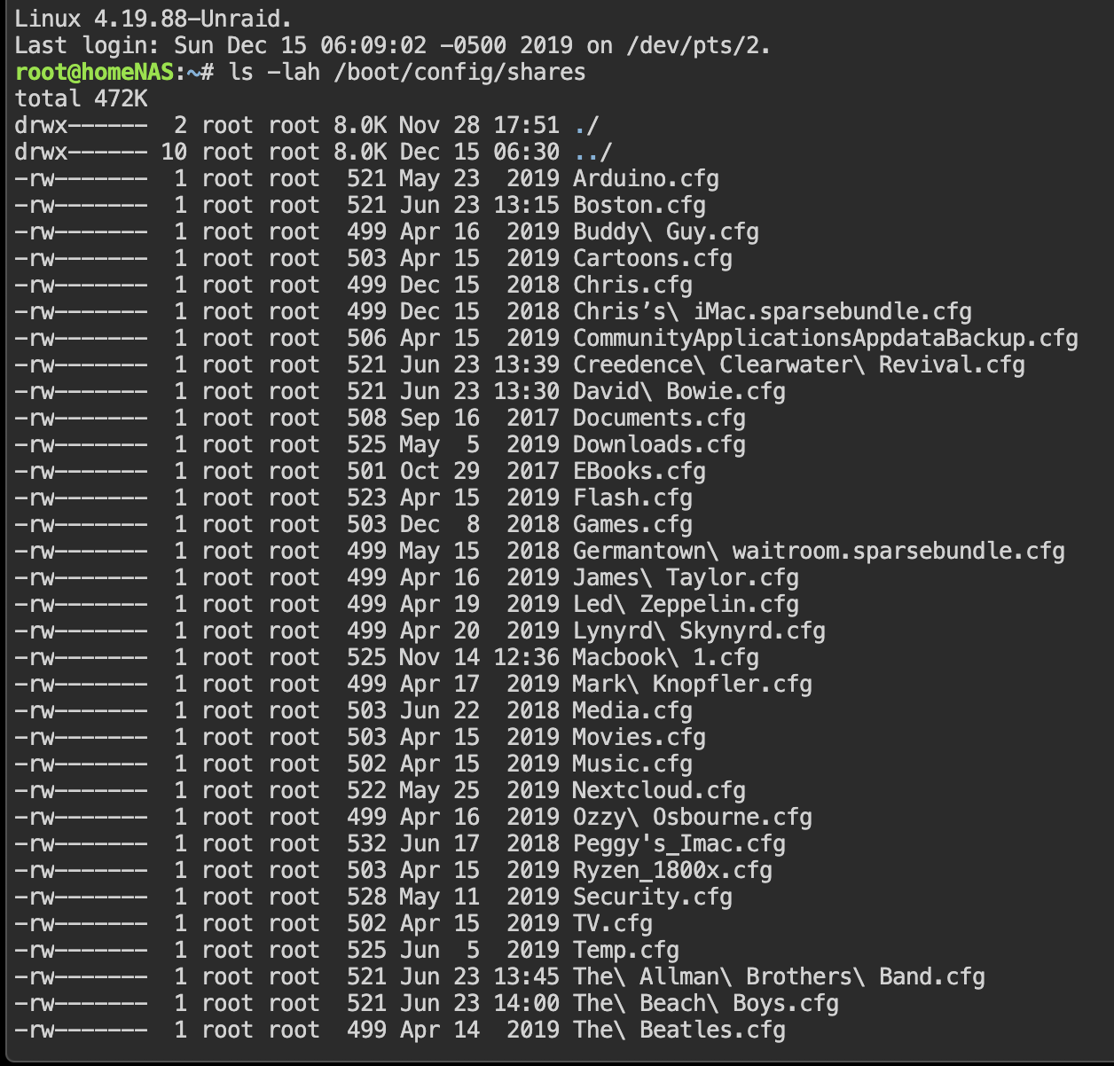

Question about (ls -lah /boot/config/shares)
Totally not a cli guy so I saw this posted on another thread and I ran it on my rig out of curiosity and to continue learning this stuff and found that I clearly have had a misconfigured host path in a docker and now it seems I have a lot of garbage on my flash drive, Primarily the music .cfg files I can't seem to be able to find them in krusader to remove is this right? Kinda remember there might be a setting that protected the flash drive but don't see it so maybe I'm mistaken?

Those share cfg files would be automatically created for any top level folder, that exists now or existed at any point in the past, you can delete the cfgs for any share that no longer exists.
In the release notes for ver 6.8.0 in the Management Section:
fstab: mount USB flash boot device with root-only access
 You will need to run Krusader with root privileges now if you want to 'work' on the flash drive.
Never did that where would I find root privileges in krusader
