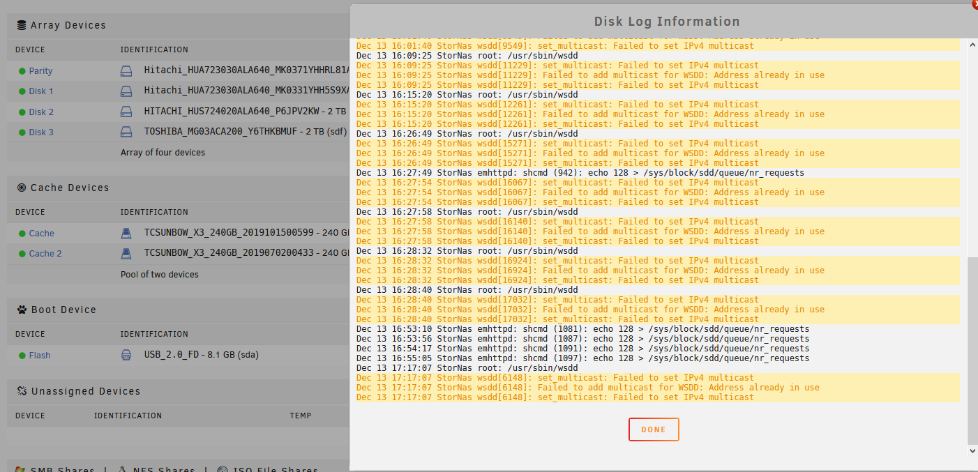

Hey my parity check seems to be taking longer than mornal for a 3tb dive, seduled to run at 11 pm and is still running at over midday the nextday reporting 5 or so hours gone. i looked at the disks logs and disk 2 i have this warning

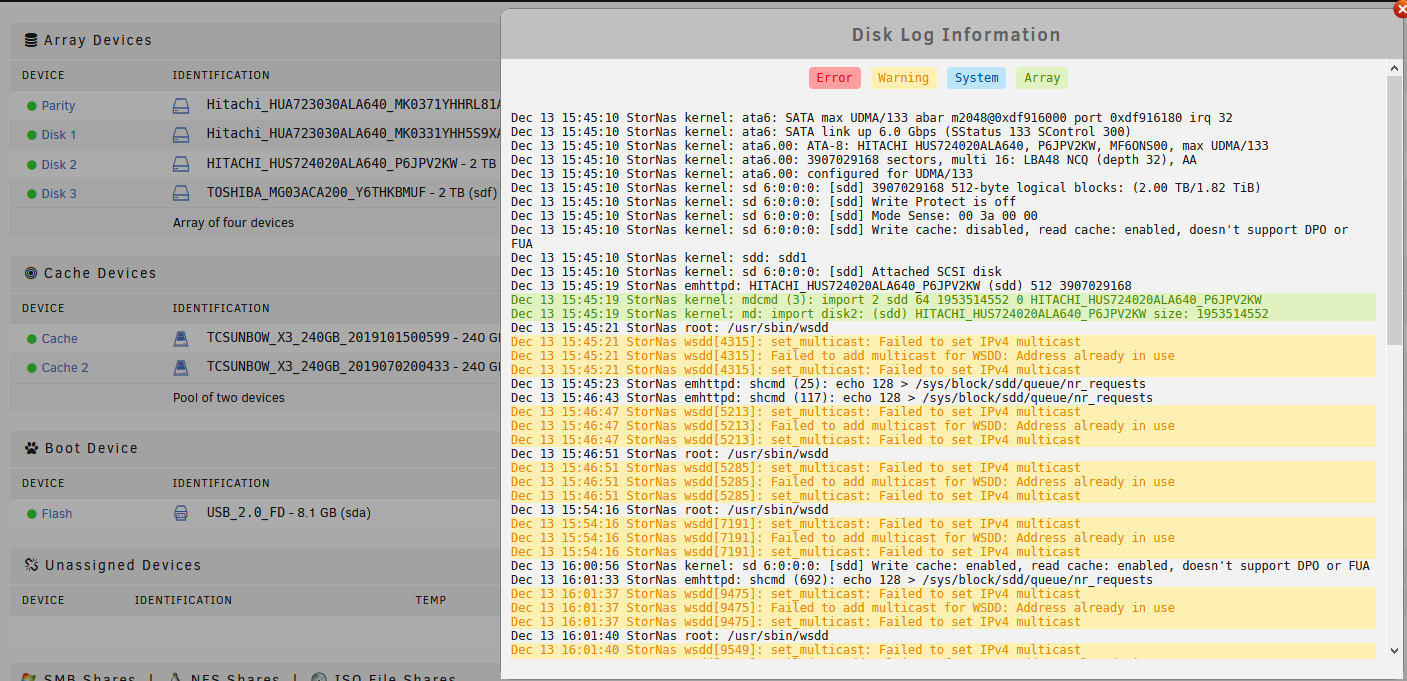

Dec 13 15:45:21 StorNas wsdd[4315]: set_multicast: Failed to set IPv4 multicast
Dec 13 15:45:21 StorNas wsdd[4315]: Failed to add multicast for WSDD: Address already in use
the other disks do not have any warnings.
the other day i had a notifaction saying 2 of my disks didnt have cache on the drives it self enabled so iveenbabled that.
Any ideas of what this warning means and if thats casusing slow checks please do let me know
Those warning are unrelated to disks, you say they appear on disk2's logs? Please post the complete diagnostics (Tools -> Diagnostics).
There are no disk related errors on the log, and parity check is going at around 57MB/s and close to the end, so that speed seems reasonable for the inner cylinders which are considerably slower then the outer ones, when it finishes compare the total time with earlier checks, but note that any array activity during the check will slow it dow considerably.
oh okay ive worked out something i ddint change the time for ths system so it thought i was 8 hours behind the time that is my time zone so so the check started at 7am for me.

Those errors are not disk related, they just appear on a disk log because sdd is part of wsdd
