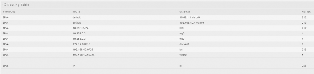

  7. I'm having a bit of networking trouble with this. I'm running in remote tunneled access from a phone and a PC. They are outside of my LAN. I can ping and connect to all LAN devices, including the unraid GUI. I have NAT off on the wireguard setup. I've also tried it with NAT on, it doesn't work. I have the static route set as instructed in the GUI. I use Unifi network gear. I am running the @SpaceInvaderOne Shinobi CCTV docker, which works great while on the LAN. My unraid machine has two NICs. eth0 is for traffic other than the CCTV, eth1 is on a separate network VLAN and is in bridge mode, br1. ShinobiCCTV on that VLAN is accessible from my main network. Firewall rules keep the cameras from reaching the internet, and the cameras can't start communications outside of their network. That whole IP range is isolated. When on the wireguard connection, I have the DNS server set to my network gateway and the internet addresses are accessible. ShinobiCCTV has its own IP address 1 lower than my unraid server, I'm using the standard port 8080. Looking in my network admin software I can see unique mac addresses for shinobiCCTV docker and Unraid on that VLAN. I SSH into my gateway and the output of "show ip route" is "S>* 10.253.0.0/24 [1/0] via 10.69.1.20, eth1" which seems correct, yes? **** As a second point.... dividing my network was based on the concept of security paranoia with IP cameras and other IOT devices. If there is a better way to do this please let me know. I'm not sure what to do here. I've searched a lot, but I don't know the next step to fix this. Thank you.
