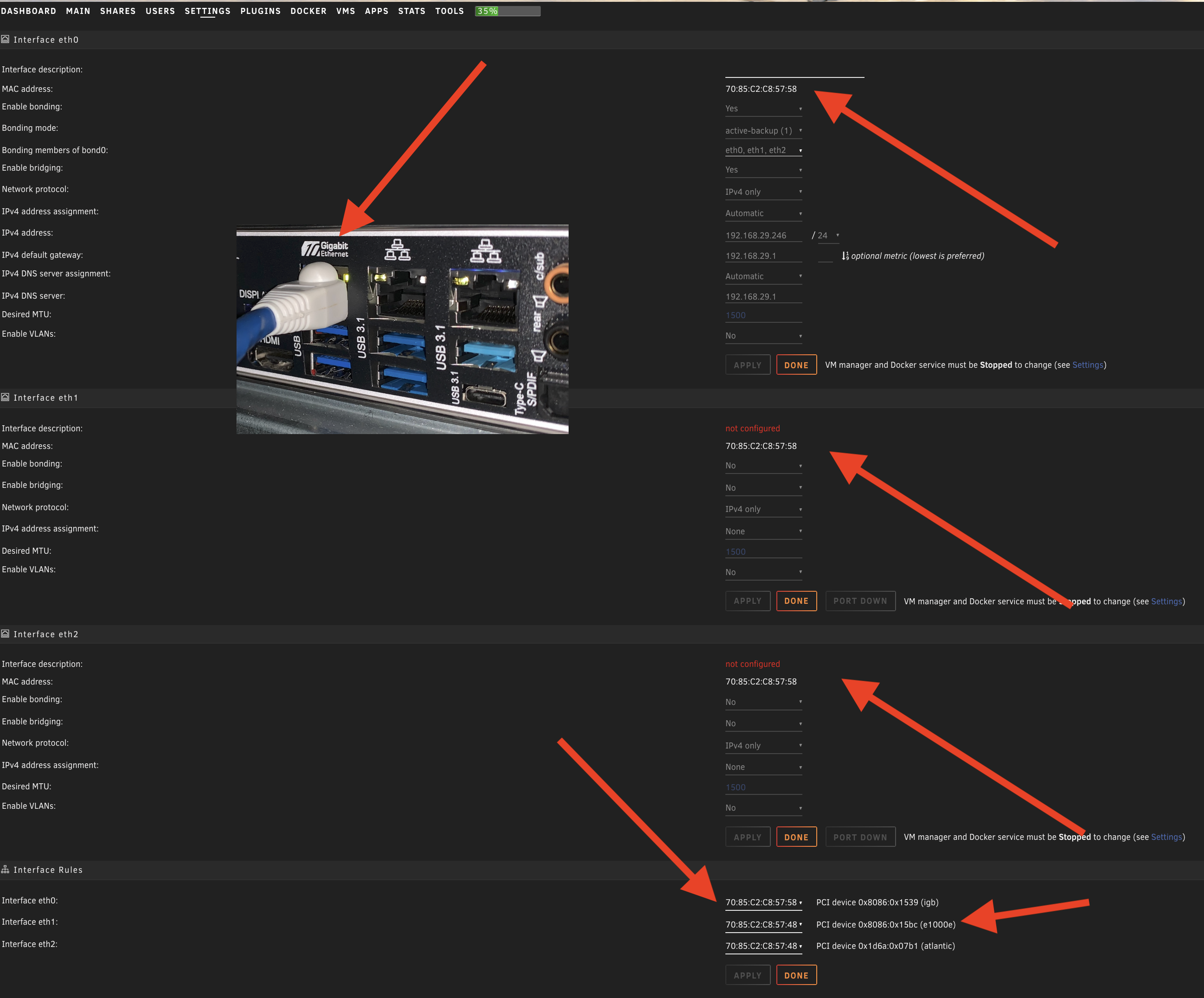

My Motherboard has 3 Network ports, (1) 10 gbe and (2) 1 gbe.. The 10 gbe is the only thing plugged in (see image below).
However, after the upgrade, not etho is now bonded with all three, when I set the no bonding, network goes down and I have to manually connect to the server with a keyboard, mouse and monitor.  For some reason eth0 is not what it should be and I cant change it.
I tried deleting the network cfg files in /boot/config/network*
but it comes back up the same way. I assume that e1000e is emulated?? since it has the same MAC address?
150467170_ScreenShot2019-12-31at2_54_20PM.thumb.png.d1ff500d8cd2b10283429caf5e9d2888.png
The only way i found the fix it is, to remove the e1000e device from the network-rules.cfg  but if I make any changes, it goes right back to they way it was

At the bottom there, where I can reassign eth0.. any changes I try to make gives the error miss matched.. because there e1000e and the Atlantic both haver the same Mac address. Which is why I thought it was emulated.
I didn't noticed the duplicated MAC address, delete /boot/network.cfg, /boot/network-rules.cfg, reboot and grab and post diags after booting is complete.
There is something seriously wrong with the MAC addresses of your interfaces. The OUI is set as ASrock, and can't be the same for different vendors (Intel and Atlantic). More over duplicate MAC addresses are not allowed.

I did that, mentioned above, but after the reboot, I get the same thing.
The only way around is to use NANO modify the Network-Rule.cfg by removing the e1000e rule, and then it works. BUT if I make any changes after that, it goes back to this crazy state.

Like bonienl mentioned both onboard NICs have the same MAC:
Dec 31 13:38:06 Valyria kernel: igb 0000:08:00.0: eth1: (PCIe:2.5Gb/s:Width x1) 70:85:c2:c8:57:58
Dec 31 13:38:06 Valyria kernel: e1000e 0000:00:1f.6 eth2: (PCI Express:2.5GT/s:Width x1) 70:85:c2:c8:57:48
So it's a borad problem, see if the linked discussion solves the issue.
