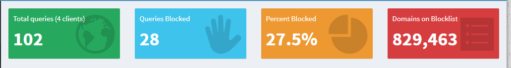

I have been trying to get this to work on and off, but so far I haven't got all the parts to play together.
my setup at the moment is
router at 192.168.0.1 with DHCP Enable
PIHole at 192.168.0.10
delugeVPN at 192.168.0.9
within PIHole I have enter in the Condition forwarding to my router
looking at my network overview it is showing all my devices.
when I do a IPconfig, I get all the right information for the DHCP = 192.168.0.1 and my DNS points to my VPN DNS 194.*.*.*
so my question is,
that when I go and have a look at at PiHole it only shows me this after 2 weeks running, is this normal and if so when is there a way to test it ?
but if I enable my PiHole DHCP then the numbers in above will be much higher.
this makes me think that someone is not talking or sending the traffic to the right location.
any ideals ?
