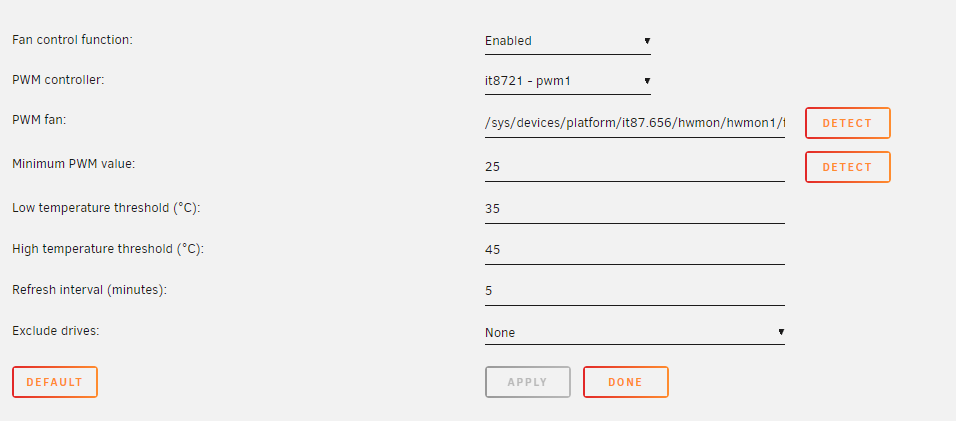

QNAP-EC Plugin -- has anyone got this working on unRAID (For those that moved from QNAP NAS)?
after a lot of playing I was about to get mine to see the fans, 🙂 so my question is - at the moment I have send mine to the following and it will spin down the fans, but will the fans come back on, if the temp is to high ?
Qnap 469 Pro - Experience with ?
has anyone got any experience with the QNAP 469 Pro model. as I have just set up my unraid on this and so far no issue's in the setting up but at the moment I have two issues, the first is the fans are running at full speed, and the other the display screen thinks it is still booting up. I have looked around and I have installing Dynamix FAN Controller Plugin, but this is not founding anything - any ideals ?
unRAID on QNAP TS-451
I have a old QNAP 469 Pro - I have been able to install Unraid on it with no issues but like other people my fans are running at full speed. I also tried Dynamix FAN Controller Plugin, but this is not founding anything - but apart from this, the transfer over to unraid on my Qnap has been painless
