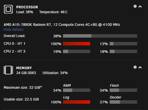

One core pinned, Log full
Sometime yesterday, I noticed that 1 core of my CPU was pinned. I realized this morning that my log file is full, as well. The specific core bounces around a bit - it will change to a different core at about 75%, then immediately climb to 100%.
I haven't a clue what's causing this, if someone can interpret the attached tea-leaves, I'd be most grateful.

It's your dockers. Look at your ps or top reports.

Gah! That makes perfect sense - I just installed EmbyStat a couple of days ago, and I guess it runs non-stop! Stopped the docker and CPU utilization dropped to normal.

The log seems to be getting spammed with tons of OOM errors like:

I notice those were at 05:39 this morning and it's currently 09:58, so it seems to have stopped 4 hours ago. Is that due to lack of space for logging (log files rotate, don't they) or did whatever was causing the OOM stop?
Where is the log located when the server is running - is this on the RAM disk? Can/should I clear the log, or will the older logs just rotate out, freeing up space? Do I need a reboot just to help things settle down? (scurries off to ensure EmbyStat is not set to auto-start!)
