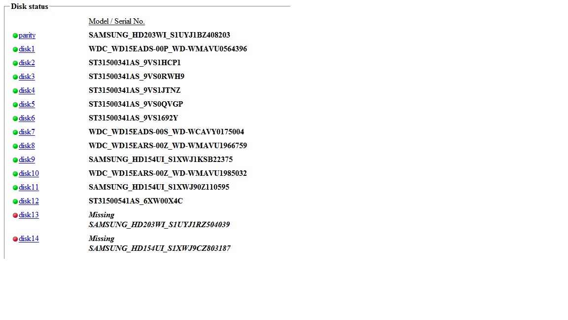

The disk was not the parity. It was the nro 10 (the screenshot was taken a month ago).
So the disk has been in use in unRAID.
Syslog attached.

Don't press anything yet, something may be wrong.  I know the screenshot is a month old, but are there still two Samsung drives missing?  If there are any missing drives, the procedure I linked above won't work.
No problem with those Rajahal!
They were before got my sunmicro cards.
So the only thing now is to determine is "Disabled disk replaced" a statement to start to rebuild?
Thanks for fast responses!
It sounds like everything is going normally.  The disk disabled is the one you are replacing, correct?  You might want to double check the serial number since you have three 1.5 TB WD EARS drives.  As long as that lines up, then you should be good to go.
