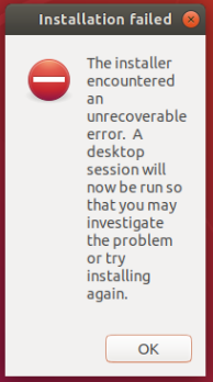

  2. No iteration of i440fx would work, all of them gave me this error.
  3. I updated it with emulation but it still didn't work.  Froze after a couple minutes after launch.

Still having this issue and having no luck trying to fix it.  There's a ton of cpu activity, but still nothing happens.  I was able to get past the installer but it still came up with an error.  Ubuntu desktop giving me a ton of headaches.
