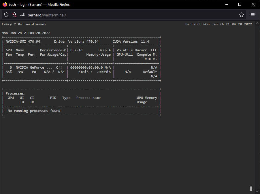

  7. I even removed my docker image and recreated it and I still cant get it working. No idea what's going on I followed the guide but its not working. EDIT: I should not that I don't there's a problem with the container, I think it's a problem with plex and my trying to use a gtx 660.
  8. Is there anything else you did to get it working? I've tried reinstalling the docker and everything else you tried and I still cant get it working. did you restart your system or docker? Plex shows that I'm using hardware transcoding, video card is going to P0 power state, yet nothing is showing up for running processes.

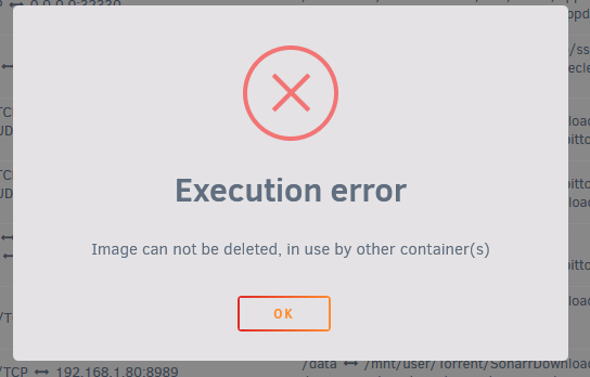

  12. @binhex this might be a dumb question, but have you run in to issues with multiple containers for this container? I've noticed some odd behavior where it seems like multiple containers are using the same image file. And I wonder if this is part of my webUI issue. Here's a couple screenshots of what I'm talking about. Currently I have two containers running, one for radarr another for sonarr. I installed a third container for testing and was receiving these errors. Trying to startup a third container Removing the third container and image file.
