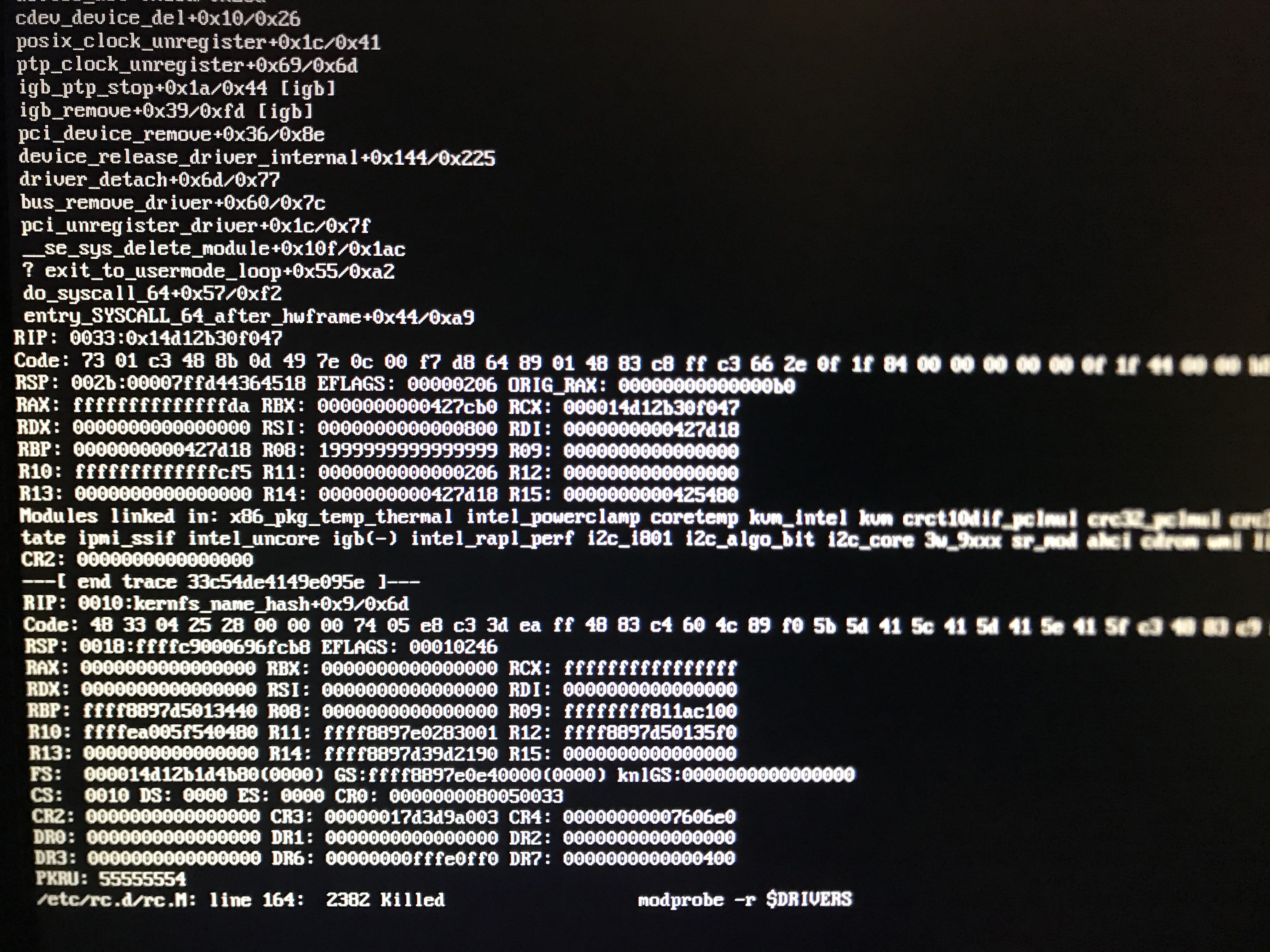

Hi, since yesterday I‘ve got problems while booting up the system.
I made a photo where the booting process stops.
Did anyone knows what to do?
Try re-doing the flash drive.
Do you have a backup of Flash?
So I found a Backup, but it is before updating to the actual version and after the backup I added one harddrive.
I was able to restore the backup to a new usb stick and updated to 6.8.1.
How can I add the new HDD without loosing any data.
BTW the old stick could be opened on a PC
OK, Server is up again an parity check runs.
Thanks

1. copied the old backup I fond to a new USB Stick
2. Booted the server with the new stick.
3. Updated to the actual version of the corrupted Stick
4. looked into the super.dat on the corrupted USB-Stick for the HDD sequence of the array
5. made a new array and selected the same sequence of the HDD's
6. started the array and taaaadaaaaa all data is back and syncing started.
