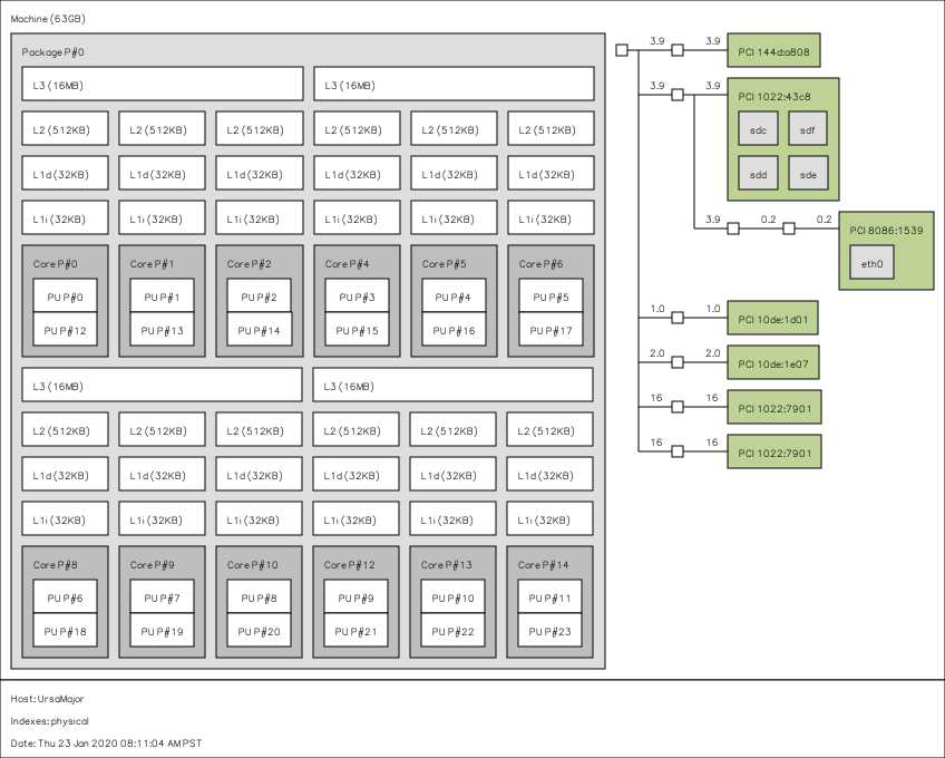

I would try shifting all your cores to the highest cores on your CPU and leave the lowest for the host. Also, maybe limit your VM cores to the ones on the same CCX so they don't have to talk over the InfinityFabric. I tried to find an lstopo of the 3900x on Google but I couldn't find one. Maybe post yours here?

@JesterEE thanks a lot for the information. I implemented your hints but also without success. Multi thread performace is great single thread performance still sux.
Here is the output of lstopo:
@Skitals How do I use an uptodate kernel with Unraid? How do I install a new kernel?
Edited by SignorRossi

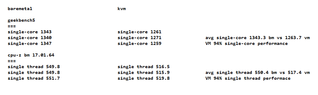

Thanks for the update. I was just going to post an update and eat some crow, because my single-core benchmarks are similar to yours:
I think 94% of bare metal performance is about what is expected, and that's the same as you posted in your original post. I'm very curious, with your changes, did that improve your cpu-z benchmark figure?
I did play some gta5 and didn't see any slowdowns (playing >120fps at 1440p on 144hz freesync monitor). The game sounds notoriously cpu-bound. I tried doing some benchmarks but it seems ALL over the place. Especially for min fps. Some runs I would get 9 min fps... on bare metal. That doesn't translate on screen or in gameplay, I think it's literally the first few frames when the pass first starts. For my VM I am passing 10c/20t, so that might be giving me the edge.
