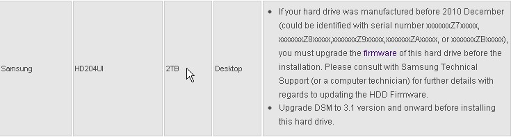

Attached is Synology's compatibility notes for the HD204UI.
