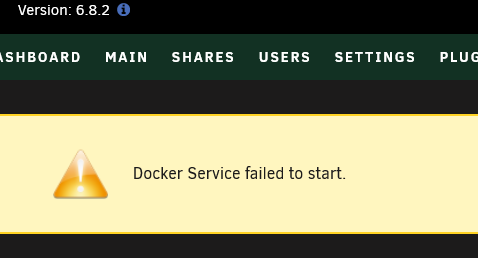

maybe I need to start over with my server...  I having issues
one the Recycling bin  process sat for an 40 min or so  at the bottom of screen as it disabled  VMS and Dockers
its now done I guess but Dockers still offline
here is diagnostic file  maybe you can see...  as maybe I just need to do a fresh setup  and transfer over
and can you tell me if the array files are not corrupt etc.. then I wouldn't have to re copy all that    and maybe only dockers and vms..
as I have not tried just swapping mobos and seeing if  that corrects all errors
from my current glitchy board
