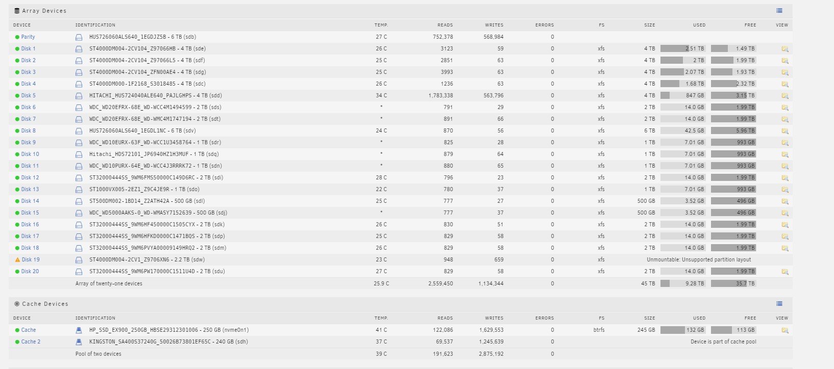

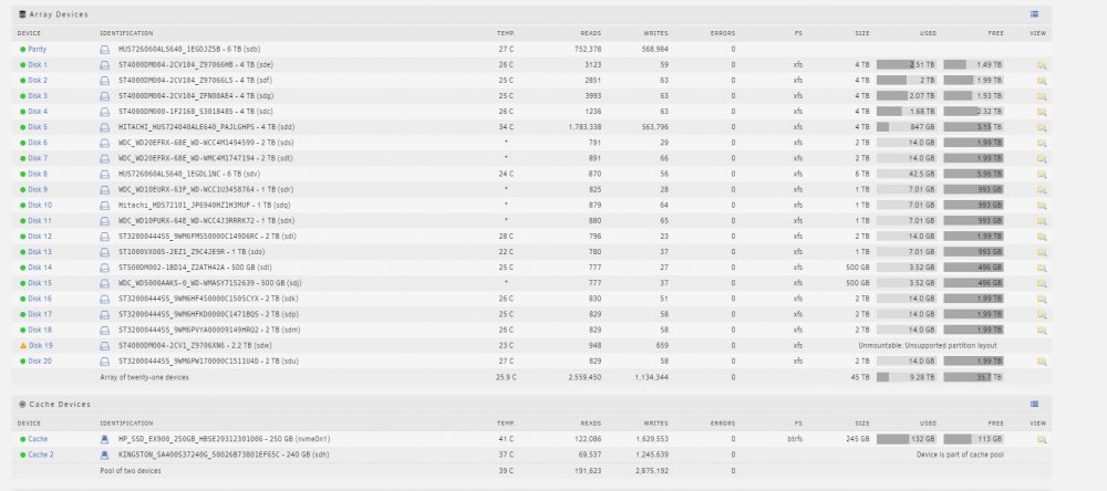

When I tried to add the 4tb drive, for some reason it keeps wanting to Sync will start Parity-Sync and/or Data-Rebuild if I let it do that it formats itself to 2.2 tb and will not let me add it to the array, it says
xfs Unmountable: Unsupported partition layout and shows as a 2.2tb drive I have pulled it and deleted the partition and formatted on a windows machine but it keeps doing the same thing. This just makes no sense.

That's because you're replacing a disk, not adding one, current diags start with that disk already disable so can't see what happened but I would guess the smaller disk was not removed correctly.
Disk is showing as 2.2TB because it's on a controller that doesn't support larger disks, also likely why it's failing to format, though it shouldn't, but same happened recently to another user.
