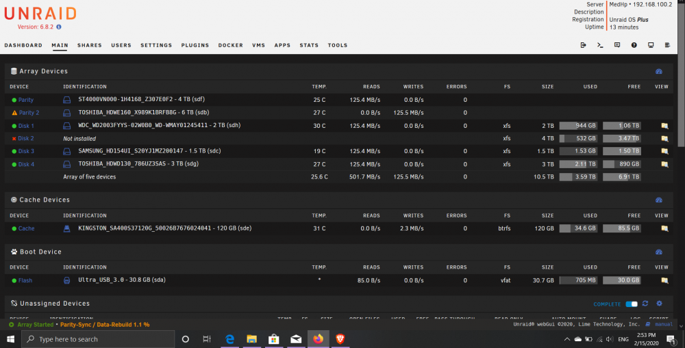

Hello community I have a small problem. One of my drives 4 Tb one just kicked of.... And I bought 2 HDD each of 6 TB..... Added one as a parity HDD and one I want to replace the dead one... but when I try to replace it says that my HDD is bigger then the parity one. Can anyone help me?
one HDD is Toshiba 6 TB and one is an WD 6 TB
Parity 0 is a  4 TB HDD
Parity 2 is a  6 TB  HDD from Toshiba

Was it your intention to have dual parity when you were finished?
No . my intention is to have one parity and one new drive.... My parity was 4 Tb and the hdd I bought was 6 TB... sow I bought a new 6 Tb ... to have a 6 Tb parity Hdd and a  6 TB HDD for the array. because unraid told me I can have an array hdd biger then the parity
You were going about it wrong then. Parity swap would have been the way to go, you should have asked before doing anything.
Parity2 is not interchangeable with parity, and no data drive can be larger than any parity drive.
I think you can stop parity2 sync, unassign parity2, then you will be at a position to do the parity swap with parity. Study the link given earlier and let us know if you have questions.
