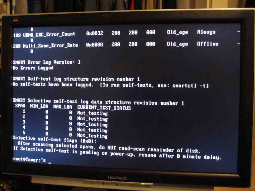

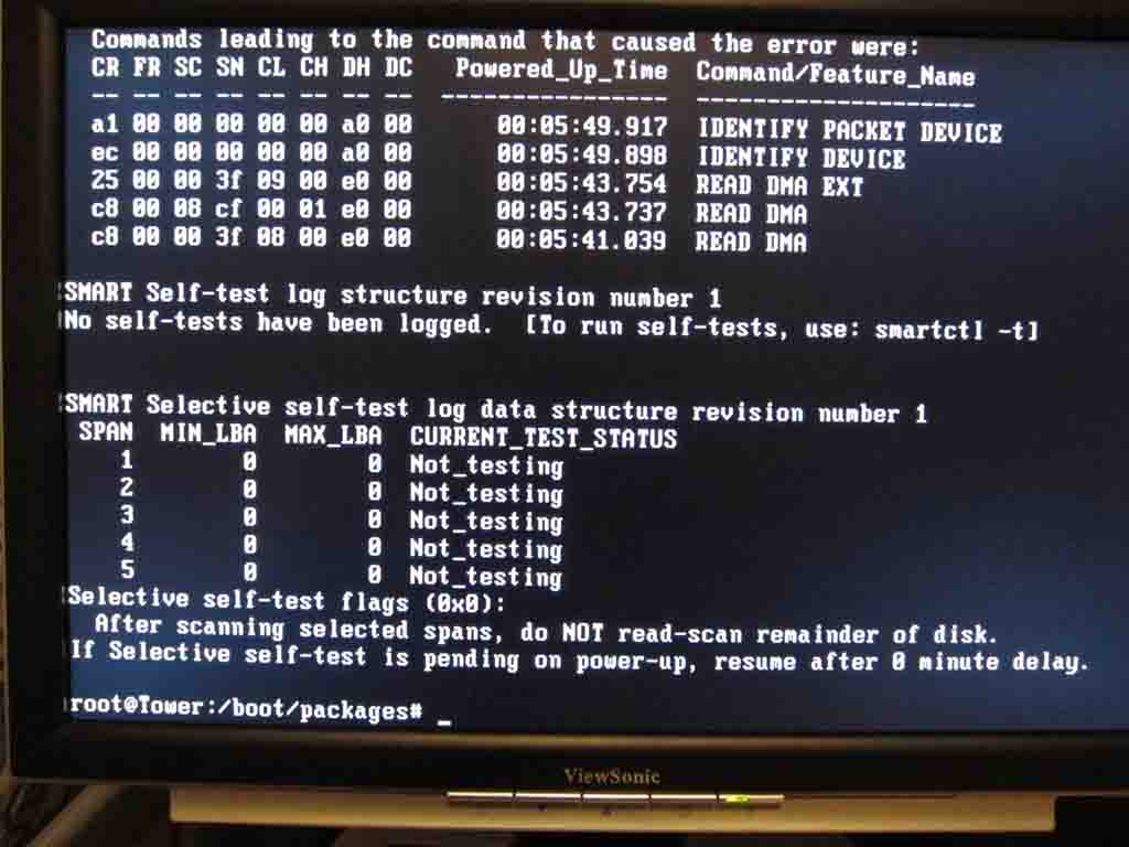

i ran smartctl but found out that version 4.4.2 doesn't have it so i followed your instructions at this link http://lime-technology.com/forum/index.php?topic=2817.msg23548#msg23548
is the smartctl saved somewhere? i attached a photo of what came up on the screen also the new syslog
syslog.txt
this is the smart for disk14
To capture the output of a command re-direct the output into a file, then you can attach the files.

The picture of the tail end of the smart output is not showing the section I need to see.
