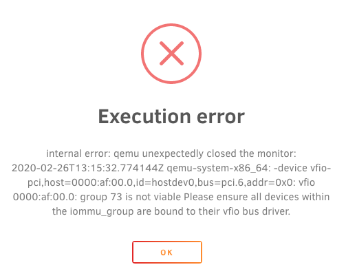

This is the error message as is, with braking up IOMMU groups.

The RTX 2080 has FOUR devices (GPU, HDMI audio, 2x USB devices i.e. everything you see in IOMMU group 73) that must be passed through together for it to work, regardless of IOMMU grouping (i.e. regardless of ACS Override).
Your xml only includes the GPU and HDMI audio and is missing the other 2 devices.
Go to the app store and look for VFIO PCI Cfg plugin and install it.
Then Settings -> VFIO PCI Cfg -> tick all 4 devices in group 73 -> build VFI-PCI.cfg -> reboot.
The 2 USB devices should now show up in the Other PCI Devices section in your VM template for you to select.
