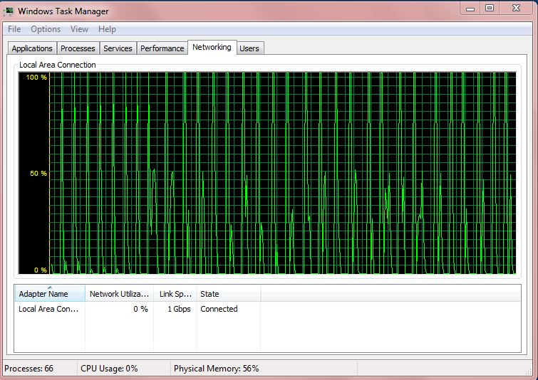

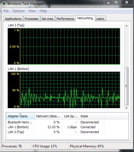

Just built an unRAID box, and moving my files over from two separate Windows boxes. I'm seeing two very different patterns from the boxes (see attached screenshots). unRAID box is set up with cache drive.
The "A" box copies at ~35MB/S
The "B" box copies at ~5-8MB/S.
I'm guessing it's not an unRAID issue, since nothing changed between the two writes. I've looked at all my Win7 settings, and they appear identical. Is this normal? Any ideas on how to fix?

Thanks prostuff. I've done all the above, no improvement. Copies between the two Windows machines saturate the GBE link and run @ ~80-90MB/s.

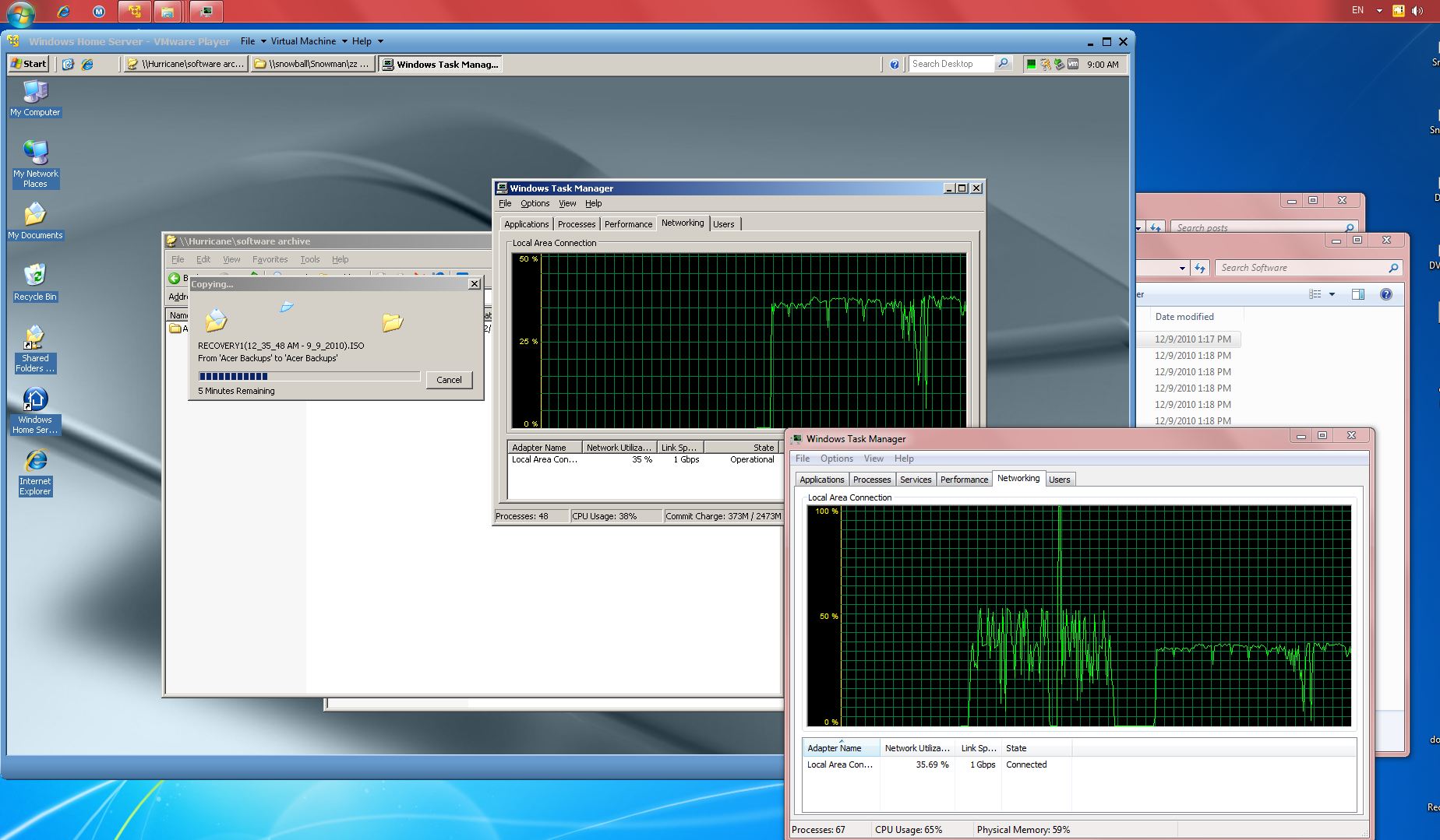

I don't think it's the hardware... here's a screenshot of something interesting:
I booted up a VM instance of Windows Home Server INSIDE the "B" box. Let's call that B.1. I then tried to copy from B.1 to unRAID, and the network utilization smoothes out. I then tried to copy from the host B box to unRAID, and the spikiness reduced a little bit, but still all over the place. See above - in the foreground window, the left side of the trace is from B, the right side of the trace is from B.1. In the background you see the B.1 VM with it's internal trace. (The "dip" in the B.1 transfer rate was when I tried to do a screen capture...)
What's causing this? Are there differences between the way WinServer 2003 and Win7 is set up for network transfers?
