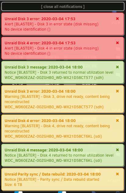

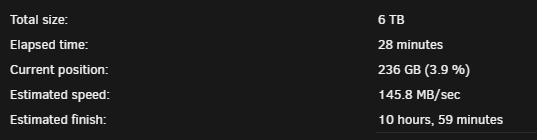

A few things, for others who might want to try this:
- Stopped the array
- Pulled 2x 3TB drives (#3 and #4)
- Insterted first 6TB disk (replacing #3), and waited a few minutes for drive to come online
- Checked UI, confirmed 6TB disk, and assigned to #3
- Insterted second 6TB disk (replacing #4), and waited a few minutes for drive to come online
- Checked UI, confirmed 6TB disk, and assigned to #4
- Started the array
Looks like things are rebuilding properly:
Capture_array_replace_2_drives_pic1.PNG.e4205a50fb947251159b5d9df59582fa.PNGCapture_array_replace_2_drives_pic2.PNG.df7cba8bfa407df6ebc5dd09fba890b9.PNG
Looks like things are rebuilding, and my data is still accessible while its emulated. Great.
